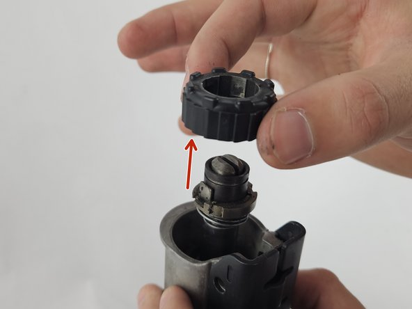

  11. Milwaukee Sawzall 6520-21 Blade Clamp/Torsion Spring Replacement, Blade Clamp and Torsion Spring: crwdns2935265:011crwdnd2935265:01crwdnd2935265:01crwdne2935265:0
    • Position the transmission housing upright so the blade clamp assembly faces upwards.

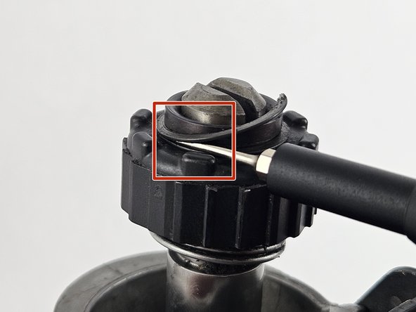

  12. Milwaukee Sawzall 6520-21 Blade Clamp/Torsion Spring Replacement: crwdns2935265:012crwdnd2935265:01crwdnd2935265:03crwdne2935265:0 Milwaukee Sawzall 6520-21 Blade Clamp/Torsion Spring Replacement: crwdns2935265:012crwdnd2935265:02crwdnd2935265:03crwdne2935265:0 Milwaukee Sawzall 6520-21 Blade Clamp/Torsion Spring Replacement: crwdns2935265:012crwdnd2935265:03crwdnd2935265:03crwdne2935265:0
    • Using a flathead screwdriver, insert the head of the driver vertically and twist clockwise to pry the retaining snap ring open and off the blade clamp assembly.
    • Slide the blade clamp upwards.

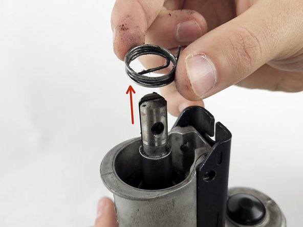

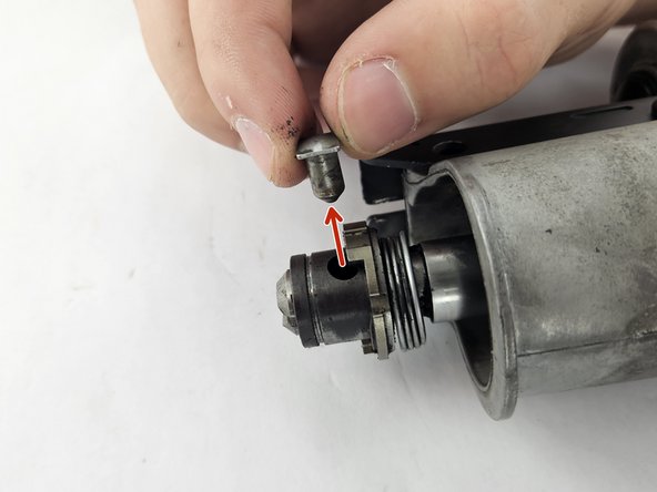

  13. Milwaukee Sawzall 6520-21 Blade Clamp/Torsion Spring Replacement: crwdns2935265:013crwdnd2935265:01crwdnd2935265:02crwdne2935265:0 Milwaukee Sawzall 6520-21 Blade Clamp/Torsion Spring Replacement: crwdns2935265:013crwdnd2935265:02crwdnd2935265:02crwdne2935265:0
    • To replace the torsion spring, use the flathead to pry the retaining pin beneath its square head.
    • Pull the retaining pin out.

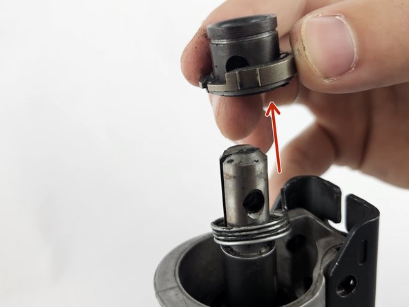

  14. Milwaukee Sawzall 6520-21 Blade Clamp/Torsion Spring Replacement: crwdns2935265:014crwdnd2935265:01crwdnd2935265:03crwdne2935265:0 Milwaukee Sawzall 6520-21 Blade Clamp/Torsion Spring Replacement: crwdns2935265:014crwdnd2935265:02crwdnd2935265:03crwdne2935265:0 Milwaukee Sawzall 6520-21 Blade Clamp/Torsion Spring Replacement: crwdns2935265:014crwdnd2935265:03crwdnd2935265:03crwdne2935265:0
    • Pull and slide the assembly and torsion spring off of the spindle.
