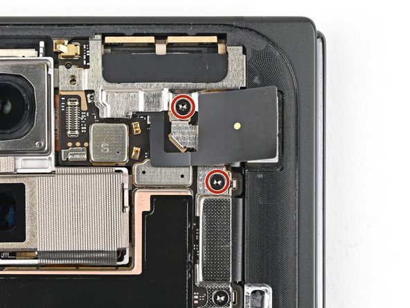

Google Pixel 9 Pro Fold Logic Board Removal, Remove the ultra wideband bracket screws: crwdns2935265:00crwdnd2935265:01crwdnd2935265:02crwdne2935265:0 Google Pixel 9 Pro Fold Logic Board Removal, Remove the ultra wideband bracket screws: crwdns2935265:00crwdnd2935265:02crwdnd2935265:02crwdne2935265:0
  • Use a Torx Plus 3IP driver to remove the two 3.0 mm‑long screws securing the ultra wideband bracket.
