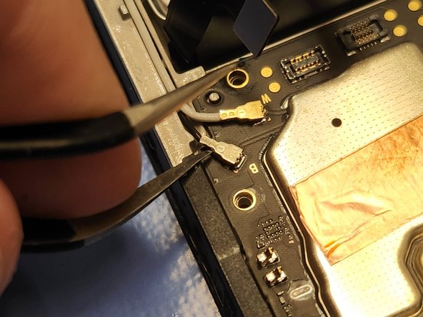

Disconnect the Antenna
  • Use your Tweezers to disconnect the two Antennas from the motherboard.
  • Make sure to only pull up on the metal tip of the antenna. Pulling on the wire can damage the antenna.
