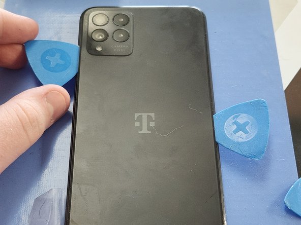

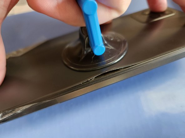

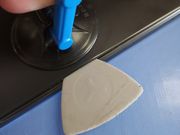

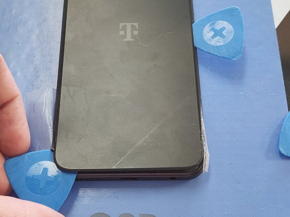

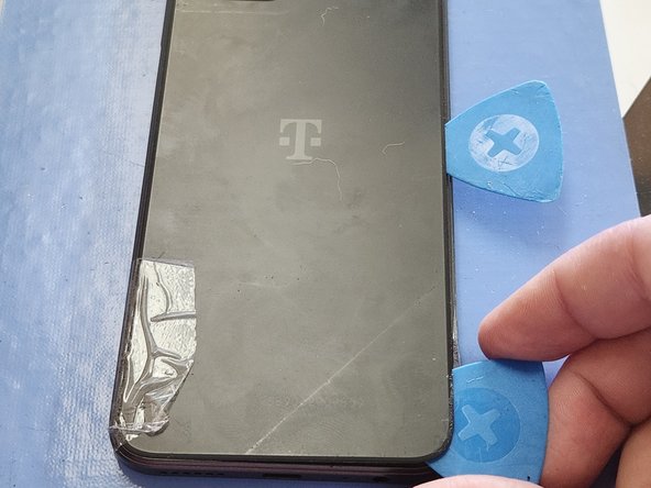

  2. Revvl 6 Pro 5G Screen Replacement, Insert an Opening Pick: crwdns2935265:02crwdnd2935265:01crwdnd2935265:03crwdne2935265:0 Revvl 6 Pro 5G Screen Replacement, Insert an Opening Pick: crwdns2935265:02crwdnd2935265:02crwdnd2935265:03crwdne2935265:0 Revvl 6 Pro 5G Screen Replacement, Insert an Opening Pick: crwdns2935265:02crwdnd2935265:03crwdnd2935265:03crwdne2935265:0
    • Before working on this device, prepare to heat it up to soften the adhesive. You can use a heat mat (in this guide's photos), but you can also use a hair dryer, heat gun, iOpener, or whatever method you have available.
    • Once the back is properly heated, apply your Suction Cup to the right side. Pull up hard to break the seal and allow a gap for your Opening Pick to slide in.
    • After your Opening Pick is in, you can remove the Suction Cup.

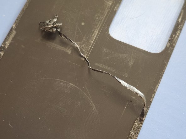

  3. Revvl 6 Pro 5G Screen Replacement, Separate the Adhesive: crwdns2935265:03crwdnd2935265:01crwdnd2935265:03crwdne2935265:0 Revvl 6 Pro 5G Screen Replacement, Separate the Adhesive: crwdns2935265:03crwdnd2935265:02crwdnd2935265:03crwdne2935265:0 Revvl 6 Pro 5G Screen Replacement, Separate the Adhesive: crwdns2935265:03crwdnd2935265:03crwdnd2935265:03crwdne2935265:0
    • Leaving your first Opening Pick where it is to prevent the adhesive from resealing, slide a second on into the gap, and down around the bottom corners.
    • If at any time it becomes difficult to cut through the adhesive, stop and apply more heat.

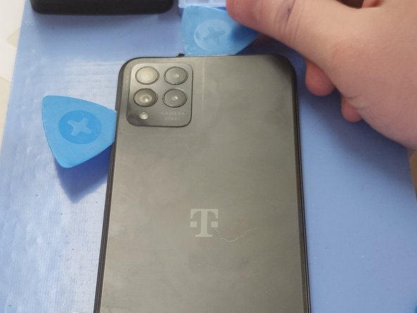

  4. Revvl 6 Pro 5G Screen Replacement: crwdns2935265:04crwdnd2935265:01crwdnd2935265:02crwdne2935265:0 Revvl 6 Pro 5G Screen Replacement: crwdns2935265:04crwdnd2935265:02crwdnd2935265:02crwdne2935265:0
    • Continue sliding that same Opening Pick up the left side, but stop when you get to the camera.
    • The camera glass is multi layered and if you don't approach it properly you can damage it.
  5. Revvl 6 Pro 5G Screen Replacement: crwdns2935265:05crwdnd2935265:01crwdnd2935265:02crwdne2935265:0 Revvl 6 Pro 5G Screen Replacement: crwdns2935265:05crwdnd2935265:02crwdnd2935265:02crwdne2935265:0
    • Going back to the original Opening Pick, slide it up the right side and around the top corner.
    • Once again, stop once you get to the camera.

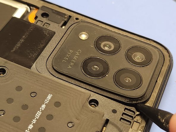

  6. Revvl 6 Pro 5G Screen Replacement: crwdns2935265:06crwdnd2935265:01crwdnd2935265:02crwdne2935265:0 Revvl 6 Pro 5G Screen Replacement: crwdns2935265:06crwdnd2935265:02crwdnd2935265:02crwdne2935265:0
    • When at the camera, tilt your Opening Pick upwards.
    • Slide your Opening Pick under the back of the phone but over the camera glass.
    • You may need to go all the way around the cameras, as there is a separate strip of adhesive around the cameras specifically.

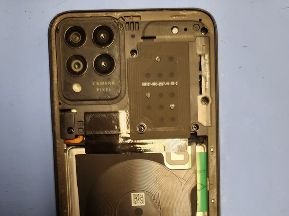

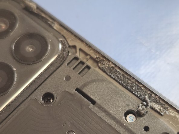

  7. Revvl 6 Pro 5G Screen Replacement, Remove the Motherboard Screws: crwdns2935265:07crwdnd2935265:01crwdnd2935265:02crwdne2935265:0 Revvl 6 Pro 5G Screen Replacement, Remove the Motherboard Screws: crwdns2935265:07crwdnd2935265:02crwdnd2935265:02crwdne2935265:0
    • Remove the 7 Screws holding the midframe in over the motherboard.
    • One of these screws has an "S" tamper evident seal. Don't miss it!
    • All of the screws used in this repair are interchangeable, and use a standard Philips #0 screwhead. No need to keep them sorted by step or location! This makes this device very user friendly!

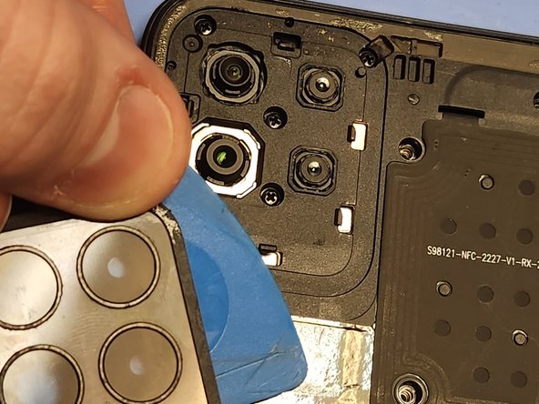

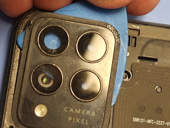

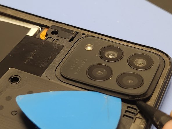

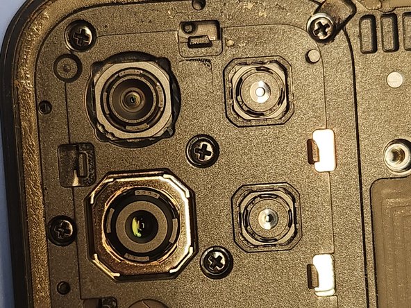

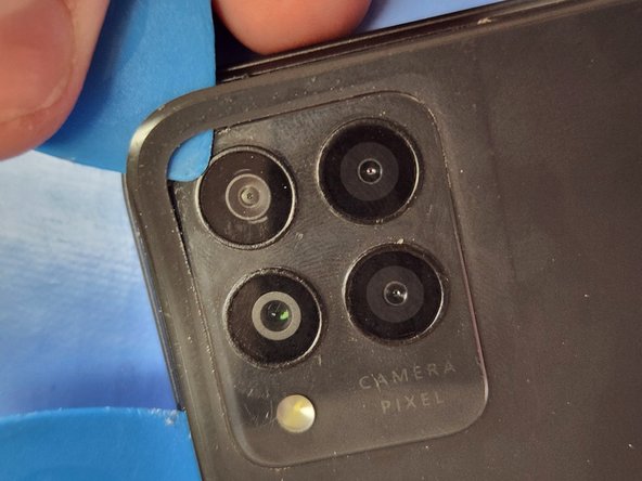

  9. Revvl 6 Pro 5G Screen Replacement, Remove the Camera Lens: crwdns2935265:09crwdnd2935265:01crwdnd2935265:03crwdne2935265:0 Revvl 6 Pro 5G Screen Replacement, Remove the Camera Lens: crwdns2935265:09crwdnd2935265:02crwdnd2935265:03crwdne2935265:0 Revvl 6 Pro 5G Screen Replacement, Remove the Camera Lens: crwdns2935265:09crwdnd2935265:03crwdnd2935265:03crwdne2935265:0
    • Insert the tip of your Spudger into the small gap at the corner of the camera lens.
    • Lift up and create a gap under the lens.
    • Insert an Opening Pick into the gap created by your Spudger.
  10. Revvl 6 Pro 5G Screen Replacement: crwdns2935265:010crwdnd2935265:01crwdnd2935265:03crwdne2935265:0 Revvl 6 Pro 5G Screen Replacement: crwdns2935265:010crwdnd2935265:02crwdnd2935265:03crwdne2935265:0 Revvl 6 Pro 5G Screen Replacement: crwdns2935265:010crwdnd2935265:03crwdnd2935265:03crwdne2935265:0
    • With your Opening Pick inserted, leverage the camera lens up and off.
    • The camera lens is held in place by both adhesive and clips, and may make two snapping sounds when being removed.
    • Make sure your Opening Pick goes under the camera lens but over the cameras themselves. If you try to force it into the sides of the cameras, you can damage them.
  11. Revvl 6 Pro 5G Screen Replacement, Remove the Camera Screws: crwdns2935265:011crwdnd2935265:01crwdnd2935265:02crwdne2935265:0 Revvl 6 Pro 5G Screen Replacement, Remove the Camera Screws: crwdns2935265:011crwdnd2935265:02crwdnd2935265:02crwdne2935265:0
    • Remove the 5 screws holding the midframe in over the cameras.

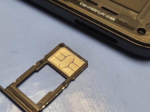

  12. Revvl 6 Pro 5G Screen Replacement, Remove the Sim Card Tray: crwdns2935265:012crwdnd2935265:01crwdnd2935265:03crwdne2935265:0 Revvl 6 Pro 5G Screen Replacement, Remove the Sim Card Tray: crwdns2935265:012crwdnd2935265:02crwdnd2935265:03crwdne2935265:0 Revvl 6 Pro 5G Screen Replacement, Remove the Sim Card Tray: crwdns2935265:012crwdnd2935265:03crwdnd2935265:03crwdne2935265:0
    • Using your Sim Card Ejection Tool, or just a paperclip, insert it into the hole of the sim card tray.
    • Pull out the sim card tray.
    • Be careful, as the phone is face down any any sim card or SD card may fall out of the tray. Make sure you do not lose these!

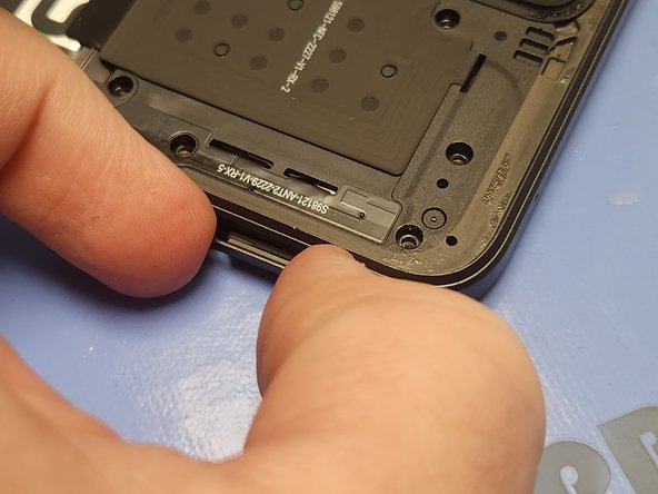

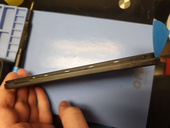

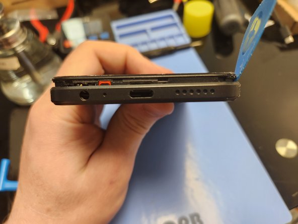

  13. Revvl 6 Pro 5G Screen Replacement, Remove the Midframe: crwdns2935265:013crwdnd2935265:01crwdnd2935265:03crwdne2935265:0 Revvl 6 Pro 5G Screen Replacement, Remove the Midframe: crwdns2935265:013crwdnd2935265:02crwdnd2935265:03crwdne2935265:0 Revvl 6 Pro 5G Screen Replacement, Remove the Midframe: crwdns2935265:013crwdnd2935265:03crwdnd2935265:03crwdne2935265:0
    • Insert an Opening Pick into the gap between the midframe and the screen frame where the sim card tray was.
    • The plastic is thinnest in this area and flexible, so you should be able to force your Opening Pick into the seam.
    • Move your Opening Pick down the right side of the phone and around the bottom corners.
    • On the left side, only move the Opening Pick up halfway, and stop before reaching the power button.
    • Go back to the right side and move your Opening Pick over the top, but stop after the top left corner before getting to the buttons.
    • Using your Opening Pick behind the buttons can damage delicate ribbon cables.

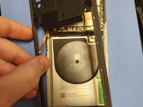

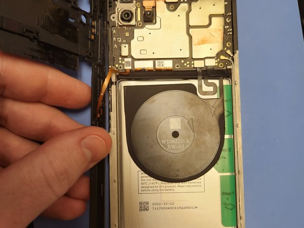

  14. Revvl 6 Pro 5G Screen Replacement: crwdns2935265:014crwdnd2935265:01crwdnd2935265:03crwdne2935265:0 Revvl 6 Pro 5G Screen Replacement: crwdns2935265:014crwdnd2935265:02crwdnd2935265:03crwdne2935265:0 Revvl 6 Pro 5G Screen Replacement: crwdns2935265:014crwdnd2935265:03crwdnd2935265:03crwdne2935265:0
    • Once the clips are released, lay the phone back down on its screen and gently lift the midframe up.
    • Open it as you would a book, making sure to treat it like a hinge on the left side, as the power button is still attached by a delicate ribbon cable.
    • Be very careful, as pulling or tugging can rip or tear this delicate ribbon cable.
    • Turn the midframe over and lie it down flipped over next to the phone.

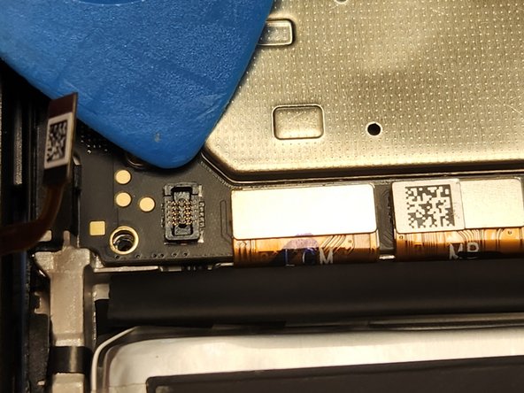

  15. Revvl 6 Pro 5G Screen Replacement, Disconnect the Power Button: crwdns2935265:015crwdnd2935265:01crwdnd2935265:02crwdne2935265:0 Revvl 6 Pro 5G Screen Replacement, Disconnect the Power Button: crwdns2935265:015crwdnd2935265:02crwdnd2935265:02crwdne2935265:0
    • With the midframe beside the phone, use an Opening Pick or Spudger to disconnect the power button from the motherboard.
    • When reassembling, this is a good time to test the phone before screwing the midframe back on and sealing it back up. If there are any issues with the new screen or the repair process, it is easiest to find them now.

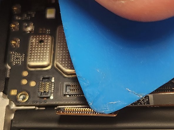

  16. Revvl 6 Pro 5G Screen Replacement, Disconnect the Battery: crwdns2935265:016crwdnd2935265:01crwdnd2935265:02crwdne2935265:0 Revvl 6 Pro 5G Screen Replacement, Disconnect the Battery: crwdns2935265:016crwdnd2935265:02crwdnd2935265:02crwdne2935265:0
    • Use an Opening Pick or Spudger to disconnect the battery from the motherboard.
  17. Revvl 6 Pro 5G Screen Replacement, Disconnect the Wireless Charging Coil: crwdns2935265:017crwdnd2935265:01crwdnd2935265:02crwdne2935265:0 Revvl 6 Pro 5G Screen Replacement, Disconnect the Wireless Charging Coil: crwdns2935265:017crwdnd2935265:02crwdnd2935265:02crwdne2935265:0
    • Use an Opening Pick or Spudger to disconnect the wireless charging coil from the motherboard.
  18. Revvl 6 Pro 5G Screen Replacement, Disconnect the Screen: crwdns2935265:018crwdnd2935265:01crwdnd2935265:03crwdne2935265:0 Revvl 6 Pro 5G Screen Replacement, Disconnect the Screen: crwdns2935265:018crwdnd2935265:02crwdnd2935265:03crwdne2935265:0 Revvl 6 Pro 5G Screen Replacement, Disconnect the Screen: crwdns2935265:018crwdnd2935265:03crwdnd2935265:03crwdne2935265:0
    • Use an Opening Pick or Spudger to disconnect the two screen connectors from the motherboard.

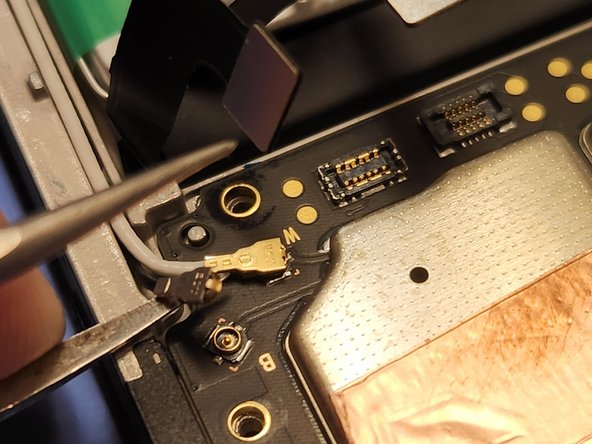

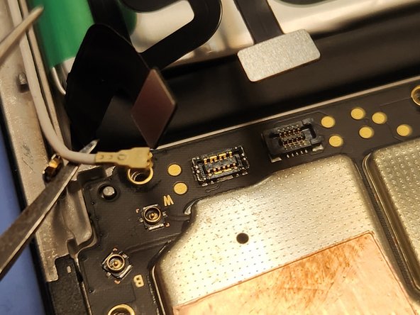

  19. Revvl 6 Pro 5G Screen Replacement, Disconnect the Antenna: crwdns2935265:019crwdnd2935265:01crwdnd2935265:03crwdne2935265:0 Revvl 6 Pro 5G Screen Replacement, Disconnect the Antenna: crwdns2935265:019crwdnd2935265:02crwdnd2935265:03crwdne2935265:0 Revvl 6 Pro 5G Screen Replacement, Disconnect the Antenna: crwdns2935265:019crwdnd2935265:03crwdnd2935265:03crwdne2935265:0
    • Use your Tweezers to disconnect the two Antennas from the motherboard.
    • Make sure to only pull up on the metal tip of the antenna. Pulling on the wire can damage the antenna.

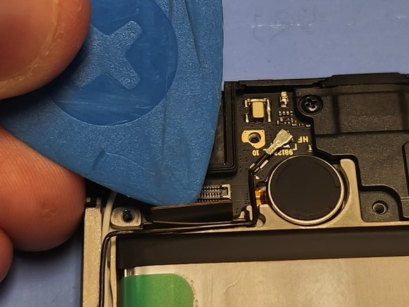

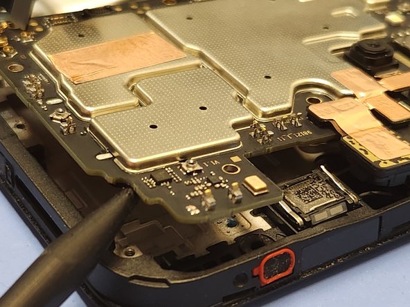

  20. Revvl 6 Pro 5G Screen Replacement, Remove the Motherboard: crwdns2935265:020crwdnd2935265:01crwdnd2935265:03crwdne2935265:0 Revvl 6 Pro 5G Screen Replacement, Remove the Motherboard: crwdns2935265:020crwdnd2935265:02crwdnd2935265:03crwdne2935265:0 Revvl 6 Pro 5G Screen Replacement, Remove the Motherboard: crwdns2935265:020crwdnd2935265:03crwdnd2935265:03crwdne2935265:0
    • There is a small gap in the top right corner of the phone, giving you access between the motherboard and the frame.
    • Insert your Spudger into this gap, and gently pry upwards. The motherboard should now lift freely away from the frame of the screen.
    • For the purposes of this repair, we are leaving the cameras all attached to the motherboard. They will come up along with the motherboard.

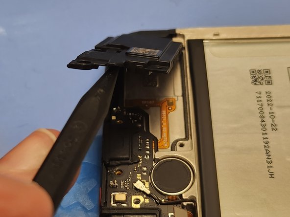

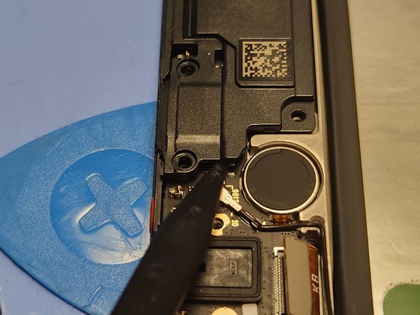

  21. Revvl 6 Pro 5G Screen Replacement, Remove the Loudspeaker: crwdns2935265:021crwdnd2935265:01crwdnd2935265:02crwdne2935265:0 Revvl 6 Pro 5G Screen Replacement, Remove the Loudspeaker: crwdns2935265:021crwdnd2935265:02crwdnd2935265:02crwdne2935265:0
    • Remove the 2 screws holding the loudspeaker in over the daughterboard.
  22. Revvl 6 Pro 5G Screen Replacement: crwdns2935265:022crwdnd2935265:01crwdnd2935265:03crwdne2935265:0 Revvl 6 Pro 5G Screen Replacement: crwdns2935265:022crwdnd2935265:02crwdnd2935265:03crwdne2935265:0 Revvl 6 Pro 5G Screen Replacement: crwdns2935265:022crwdnd2935265:03crwdnd2935265:03crwdne2935265:0
    • There is a small gap on the far right side of the loudspeaker, giving you access between the speaker and the daughterboard.
    • Insert your Spudger into this hole, and gently pry upwards. The loudspeaker should now lift freely away from the frame of the daughterboard.

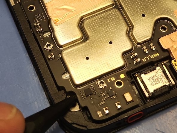

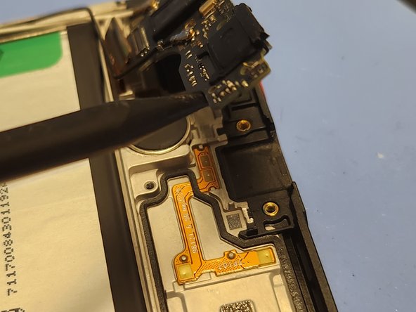

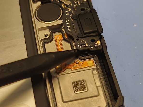

  25. Revvl 6 Pro 5G Screen Replacement, Remove the Daughterboard: crwdns2935265:025crwdnd2935265:01crwdnd2935265:03crwdne2935265:0 Revvl 6 Pro 5G Screen Replacement, Remove the Daughterboard: crwdns2935265:025crwdnd2935265:02crwdnd2935265:03crwdne2935265:0 Revvl 6 Pro 5G Screen Replacement, Remove the Daughterboard: crwdns2935265:025crwdnd2935265:03crwdnd2935265:03crwdne2935265:0
    • There is a small gap in the top left corner of the daughterboard, giving you access between the daughterboard and the frame.
    • Insert your Spudger into this gap, and gently pry upwards. The daughterboard should now lift freely away from the frame of the screen.
    • For the purposes of this repair, we are leaving the antennas attached to the daughterboard. They will come up along with the daughterboard.

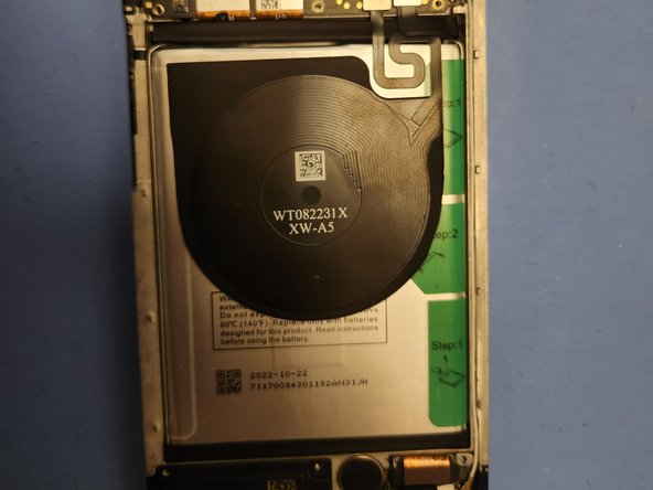

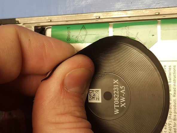

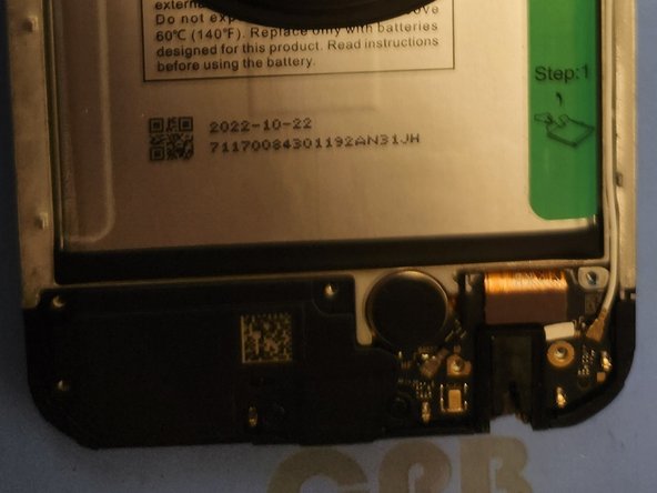

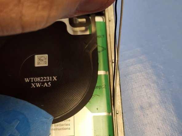

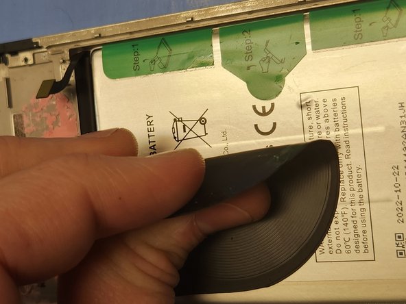

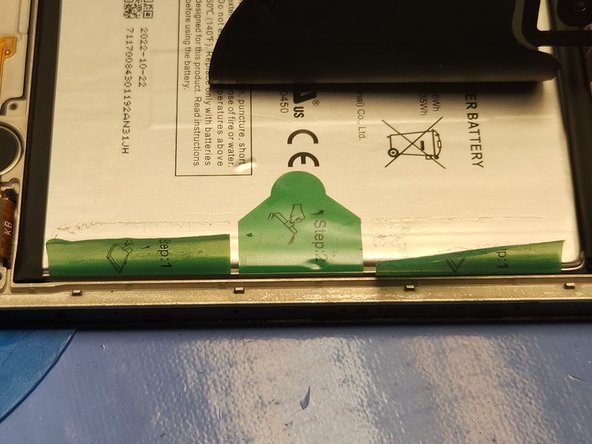

  26. Revvl 6 Pro 5G Screen Replacement, Release the Battery: crwdns2935265:026crwdnd2935265:01crwdnd2935265:03crwdne2935265:0 Revvl 6 Pro 5G Screen Replacement, Release the Battery: crwdns2935265:026crwdnd2935265:02crwdnd2935265:03crwdne2935265:0 Revvl 6 Pro 5G Screen Replacement, Release the Battery: crwdns2935265:026crwdnd2935265:03crwdnd2935265:03crwdne2935265:0
    • Carefully peel back the wireless charging coil from the right side of the battery to reveal the tabs underneath.
    • It is not required to remove the wireless charging coil entirely from the battery for this repair. You may do so if you wish.

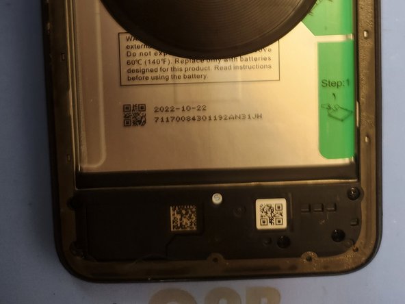

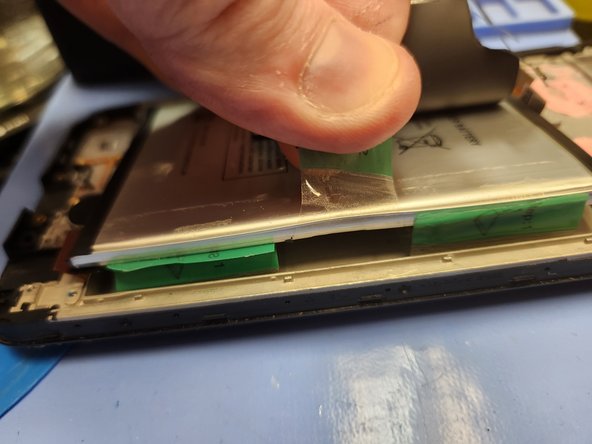

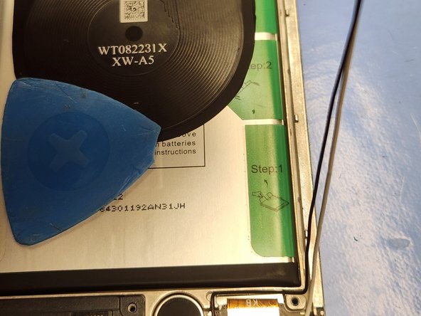

  27. Revvl 6 Pro 5G Screen Replacement: crwdns2935265:027crwdnd2935265:01crwdnd2935265:02crwdne2935265:0 Revvl 6 Pro 5G Screen Replacement: crwdns2935265:027crwdnd2935265:02crwdnd2935265:02crwdne2935265:0
    • There are two tabs on the right side of the battery marked "Step 1". These tabs are attached to the frame of the phone and should not be pulled on. They only need to be peeled away from the battery.
    • There is a large tab on the left side of the battery. This is unmarked, but should be carefully removed, as not doing so can damage the wireless charging coil if still attached.
    • There is one tab on the right side of the battery marked "Step 2". After the other tabs are peeled off the battery, this one is pulled on to remove the battery from the phone.
  28. Revvl 6 Pro 5G Screen Replacement: crwdns2935265:028crwdnd2935265:01crwdnd2935265:02crwdne2935265:0 Revvl 6 Pro 5G Screen Replacement: crwdns2935265:028crwdnd2935265:02crwdnd2935265:02crwdne2935265:0
    • With the wireless charging coil out of the way, gently peel both tabs labelled "Step 1" off of the battery.

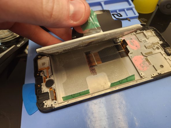

  29. Revvl 6 Pro 5G Screen Replacement, Remove the Battery: crwdns2935265:029crwdnd2935265:01crwdnd2935265:03crwdne2935265:0 Revvl 6 Pro 5G Screen Replacement, Remove the Battery: crwdns2935265:029crwdnd2935265:02crwdnd2935265:03crwdne2935265:0 Revvl 6 Pro 5G Screen Replacement, Remove the Battery: crwdns2935265:029crwdnd2935265:03crwdnd2935265:03crwdne2935265:0
    • With the wireless charging coil and all tabs peeled back, pull up forcefully on Tab 2 to pull the battery off of the frame.
    • It is more important to give consistant pulling force rather than short sharp pulls on the tab.
    • If at any time it is too difficult to pull the battery up, stop and apply heat to the screen side of the device to soften the adhesive.
    • NEVER apply heat directly to a battery.

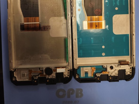

  30. Revvl 6 Pro 5G Screen Replacement, Transfer Small Parts: crwdns2935265:030crwdnd2935265:01crwdnd2935265:02crwdne2935265:0 Revvl 6 Pro 5G Screen Replacement, Transfer Small Parts: crwdns2935265:030crwdnd2935265:02crwdnd2935265:02crwdne2935265:0
    • With all major components removed, place your old screen and new screen side by side and transfer over any small parts that may be left behind.
    • The small parts you need to transfer will vary based on who supplied your replacement screen. These examples are provided as a reference based on what I found when I did this repair. You should check carefully your parts to be sure of what you do and do not need to transfer!

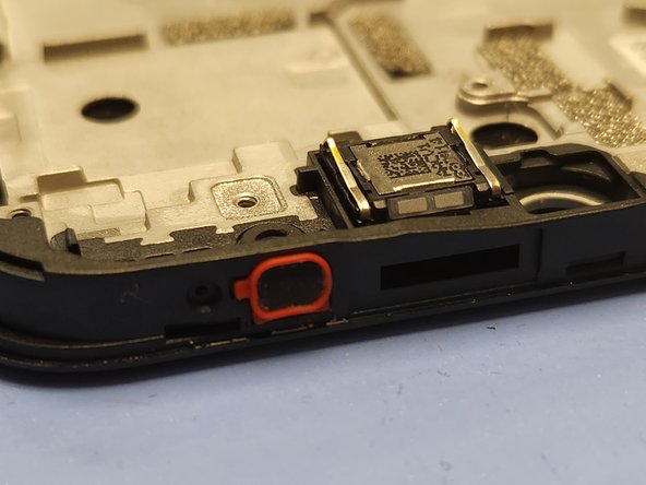

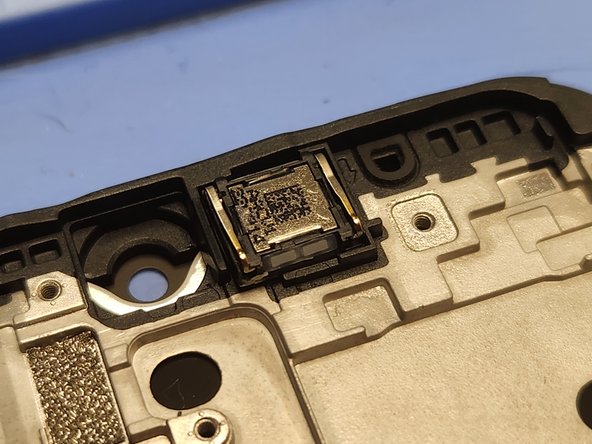

  31. Revvl 6 Pro 5G Screen Replacement, Earpiece Speaker: crwdns2935265:031crwdnd2935265:01crwdnd2935265:02crwdne2935265:0 Revvl 6 Pro 5G Screen Replacement, Earpiece Speaker: crwdns2935265:031crwdnd2935265:02crwdnd2935265:02crwdne2935265:0
    • The earpiece speaker is located here.
    • The earpiece speaker is successfully transferred to the new screen and frame.
  32. Revvl 6 Pro 5G Screen Replacement, Top Microphone Filter: crwdns2935265:032crwdnd2935265:01crwdnd2935265:02crwdne2935265:0 Revvl 6 Pro 5G Screen Replacement, Top Microphone Filter: crwdns2935265:032crwdnd2935265:02crwdnd2935265:02crwdne2935265:0
    • The top microphone filter is located here (top edge of frame).
    • The top microphone filter is successfully transferred to the new screen and frame.

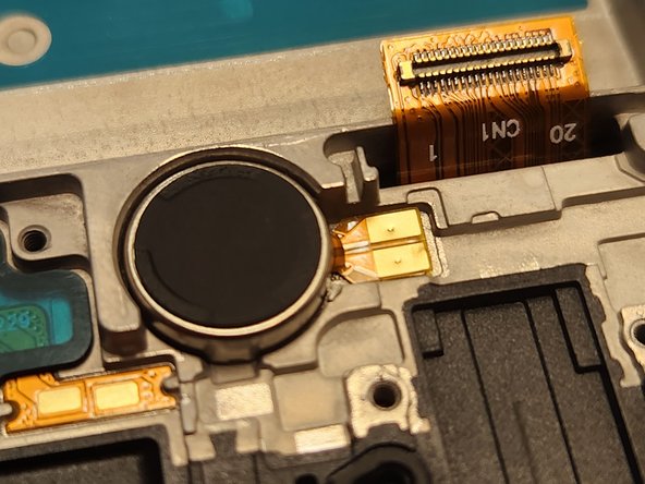

  33. Revvl 6 Pro 5G Screen Replacement, Vibration Motor and Bottom Microphone Filter: crwdns2935265:033crwdnd2935265:01crwdnd2935265:02crwdne2935265:0 Revvl 6 Pro 5G Screen Replacement, Vibration Motor and Bottom Microphone Filter: crwdns2935265:033crwdnd2935265:02crwdnd2935265:02crwdne2935265:0
    • The vibration motor is located here.
    • The bottom microphone filter is located here (bottom edge of frame).
    • The both parts are successfully transferred to the new screen and frame.

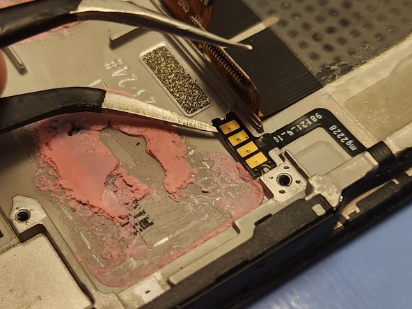

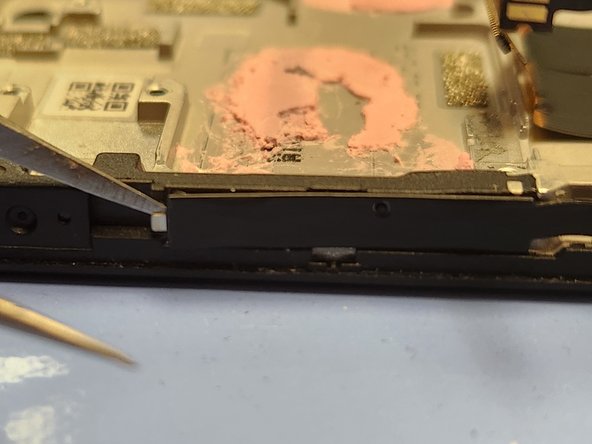

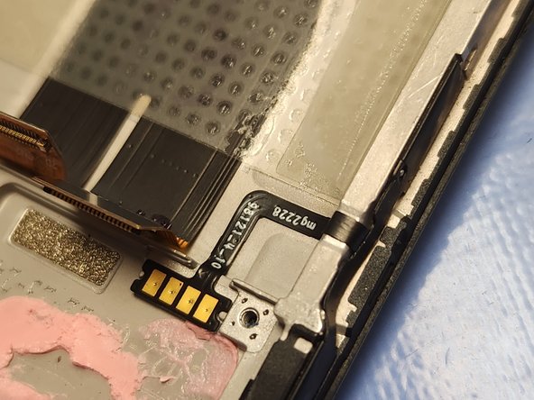

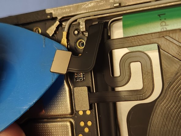

  34. Revvl 6 Pro 5G Screen Replacement, Side Buttons: crwdns2935265:034crwdnd2935265:01crwdnd2935265:03crwdne2935265:0 Revvl 6 Pro 5G Screen Replacement, Side Buttons: crwdns2935265:034crwdnd2935265:02crwdnd2935265:03crwdne2935265:0 Revvl 6 Pro 5G Screen Replacement, Side Buttons: crwdns2935265:034crwdnd2935265:03crwdnd2935265:03crwdne2935265:0
    • The side buttons are located here, on a small and delicate ribbon cable that wraps around from the left side of the frame to the inside, under the motherboard.
    • Insert the tip of your tweezers under the contact pads. There is a small gap that is hard to see that will let you get your tweezers under the contact pads to provide some leverage.
    • Once the contact pads are lifted up, gently pull the ribbon cable up with your fingers to release it from the adhesive holding it to the frame.
    • Stop pulling once you've gotten to the side of the phone. You can not yet completely remove this ribbon cable.
    • It is important that you do not insert your tweezers anywhere not recommended by this guide. Only remove the ribbon cable by gently pulling the adhesive off. Only these three spots have a metal backing that will protect the ribbon cable. Anywhere else can cut or otherwise damage the ribbon cable.

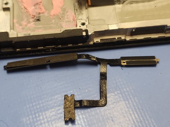

  35. Revvl 6 Pro 5G Screen Replacement: crwdns2935265:035crwdnd2935265:01crwdnd2935265:03crwdne2935265:0 Revvl 6 Pro 5G Screen Replacement: crwdns2935265:035crwdnd2935265:02crwdnd2935265:03crwdne2935265:0 Revvl 6 Pro 5G Screen Replacement: crwdns2935265:035crwdnd2935265:03crwdnd2935265:03crwdne2935265:0
    • Insert your tweezers into the small opening to the right of the ribbon cable and peel up the right side.
    • Insert your tweezers into the small opening to the left of the ribbon cable and peel up the left side.
    • Once both sides are peeled up, gently pull the ribbon cable up with your fingers to release it from the adhesive holding it to the frame.
    • With both sides and the contact pads released, you should be able to pull the ribbon cable away from the frame of the phone with no further issues.
    • After fully removing the side buttons ribbon cable, install it onto the new screen and frame.

    • When reassembling the phone, inspect the midframe and rear cover for any old adhesive seal. Make sure to completely remove any traces of it left behind.
    • Use 90%+ isopropyl alcohol on a Q-Tip, or the nearest equivalent available to you, to clean the adhesive residue off of the midframe and back cover.
    • Apply new Tesa tape or your adhesive of choice to the border of the midframe and border around the camera lens before installing the back cover onto the phone.
To reassemble your device, follow these instructions in reverse order. The camera lens will need to snap into place, and takes more force to put back than you may be expecting. Pay extra care to make sure you cleaned the old seal off properly.
