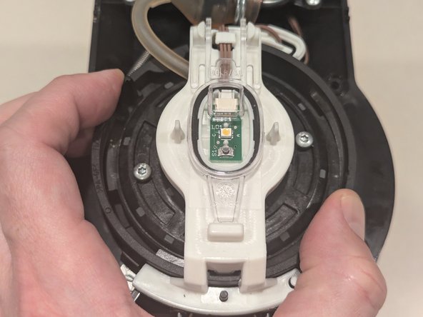

Prepare to re-attach upper cover
  • The two posts on the steamer cover (ie, on the machine head) must align with two holes in the upper plastic cover so that the release handles on the top of the upper cover properly rotate and lock the steamer, when the upper cover is attached.
  • This alignment is easiest when the machine head is in the closed and locked position:
  • Close the machine head and rotate the steamer clockwise to the locked position. The posts will be at roughly 10 and 4 o'clock.
  • On the upper side of the upper cover, rotate the release handles until the "locked" indicator lines line up.
