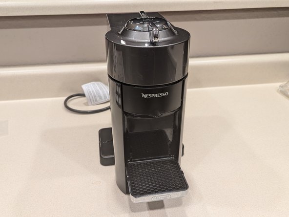

Nespresso Vertuo Evoluo Bearing Replacement
  1. Nespresso Vertuo Evoluo Bearing Replacement, Remove attachments: crwdns2935265:01crwdnd2935265:01crwdnd2935265:02crwdne2935265:0 Nespresso Vertuo Evoluo Bearing Replacement, Remove attachments: crwdns2935265:01crwdnd2935265:02crwdnd2935265:02crwdne2935265:0
    • Remove the water tank, capsule storage bin, and drip tray to make handling the machine easier.

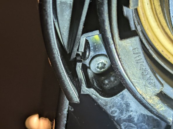

  2. Nespresso Vertuo Evoluo Bearing Replacement, Remove screws from upper cover: crwdns2935265:02crwdnd2935265:01crwdnd2935265:02crwdne2935265:0 Nespresso Vertuo Evoluo Bearing Replacement, Remove screws from upper cover: crwdns2935265:02crwdnd2935265:02crwdnd2935265:02crwdne2935265:0
    • The plastic cover on the upper hinged lid will need to be removed. Remove two Torx T10 screws that secure it in place, one from each side.
    • A small flashlight may help to locate the two screws since they are recessed ~1.5cm under the upper plastic cover.

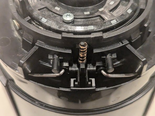

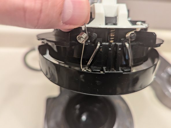

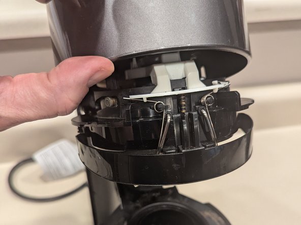

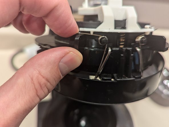

  4. Nespresso Vertuo Evoluo Bearing Replacement, Remove capsule catch bar springs: crwdns2935265:04crwdnd2935265:01crwdnd2935265:03crwdne2935265:0 Nespresso Vertuo Evoluo Bearing Replacement, Remove capsule catch bar springs: crwdns2935265:04crwdnd2935265:02crwdnd2935265:03crwdne2935265:0 Nespresso Vertuo Evoluo Bearing Replacement, Remove capsule catch bar springs: crwdns2935265:04crwdnd2935265:03crwdnd2935265:03crwdne2935265:0
    • Disengage the two spring tensioners on the capsule catch bars, one from each side: Gently bend the upper part of the spring down and rotate it out from under the plastic lip holding it in place.
    • Remove the spring from each arm of the capsule catch mechanism and set them aside. Remember which spring corresponds to which side of the mechanism.

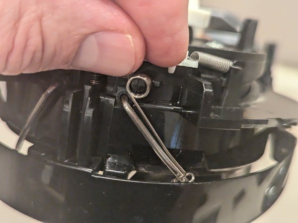

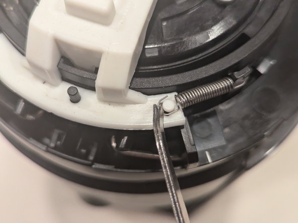

  5. Nespresso Vertuo Evoluo Bearing Replacement, Remove lid-release spring: crwdns2935265:05crwdnd2935265:01crwdnd2935265:01crwdne2935265:0
    • Remove the silver lid-release spring: remove one end from the white button bracket, and then remove the other end from the black lid-release mechanism. Tweezers or a toothpick may be helpful here.
    • This step and the following steps are easiest if the machine lid is closed.
    • Don't worry about closing the lid: You can re-open the machine lid when needed using the two black lid-release mechanism pins that are located 180 degrees apart at the top of the machine head, at roughly the 5 o'clock and 11 o'clock positions. Push them slightly counter-clockwise to open the machine lid.

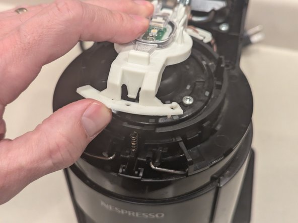

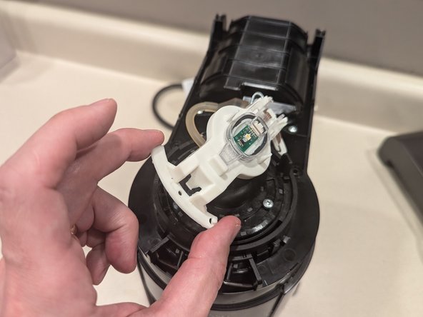

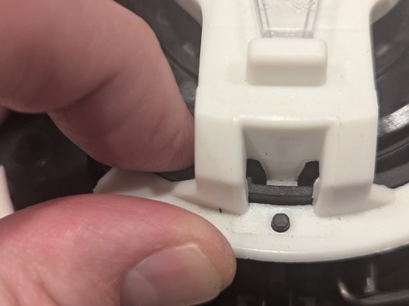

  6. Nespresso Vertuo Evoluo Bearing Replacement, Remove white button bracket: crwdns2935265:07crwdnd2935265:01crwdnd2935265:03crwdne2935265:0 Nespresso Vertuo Evoluo Bearing Replacement, Remove white button bracket: crwdns2935265:07crwdnd2935265:02crwdnd2935265:03crwdne2935265:0 Nespresso Vertuo Evoluo Bearing Replacement, Remove white button bracket: crwdns2935265:07crwdnd2935265:03crwdnd2935265:03crwdne2935265:0
    • Remove the white button bracket from the top of the machine head: using a small flat-bladed screwdriver to gently press in each of the two plastic clips holding it in place can help to safely loosen and lift it.
    • The white button bracket will remain attached to the machine by a small brown wire. Carefully rotate the white button bracket around and to the right so that you have clearance to continue disassembling the machine head.
    • Carefully lift off and set aside the small brass-colored spring that is now exposed on the front edge of the machine head.

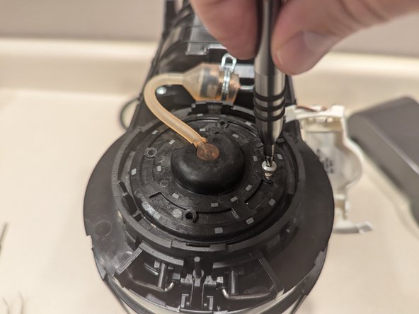

  7. Nespresso Vertuo Evoluo Bearing Replacement, Remove screws from steamer cover: crwdns2935265:08crwdnd2935265:01crwdnd2935265:01crwdne2935265:0
    • Remove the four Torx T10 screws from the steamer cover on the top of the machine head.
  8. Nespresso Vertuo Evoluo Bearing Replacement, Steamer cover and steam tube: crwdns2935265:09crwdnd2935265:01crwdnd2935265:02crwdne2935265:0 Nespresso Vertuo Evoluo Bearing Replacement, Steamer cover and steam tube: crwdns2935265:09crwdnd2935265:02crwdnd2935265:02crwdne2935265:0
    • Carefully lift off the black steamer cover from the head of the machine, and slide it gently down the silicone tube.
    • Remove the end of the silicone tube from the top of the machine head. Do not lose the metal tube at the top of the silicone tube.
    • If the metal tube falls out, it can be pushed back into place in the silicone tube; the orientation of this tube will be important when re-assembling the machine.

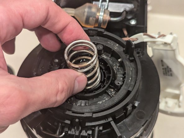

  9. Nespresso Vertuo Evoluo Bearing Replacement, Steamer lid and capsule tension spring: crwdns2935265:010crwdnd2935265:01crwdnd2935265:02crwdne2935265:0 Nespresso Vertuo Evoluo Bearing Replacement, Steamer lid and capsule tension spring: crwdns2935265:010crwdnd2935265:02crwdnd2935265:02crwdne2935265:0
    • Remove the upper steamer lid by pressing it down and rotating counter-clockwise about 30 degrees.
    • Set the lid aside, and then remove and set aside the tension spring.

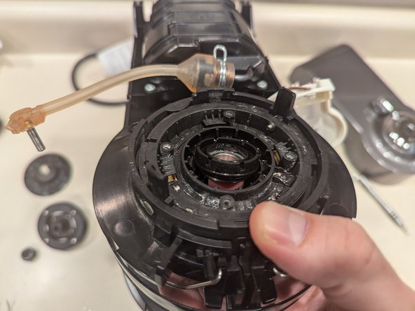

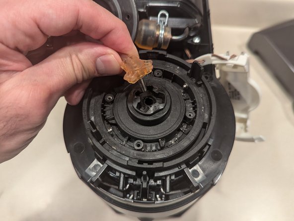

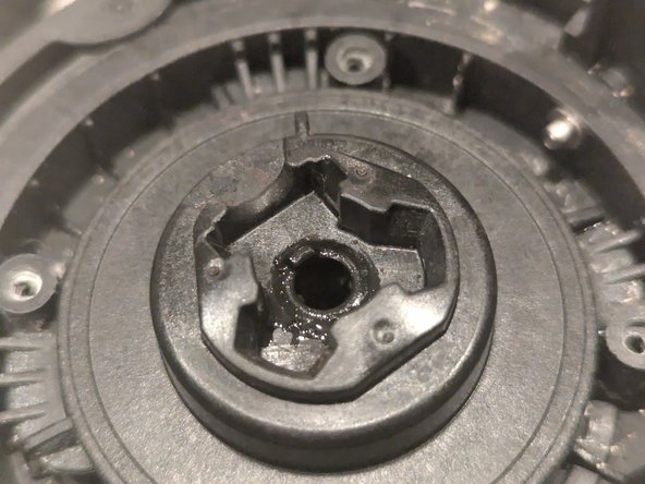

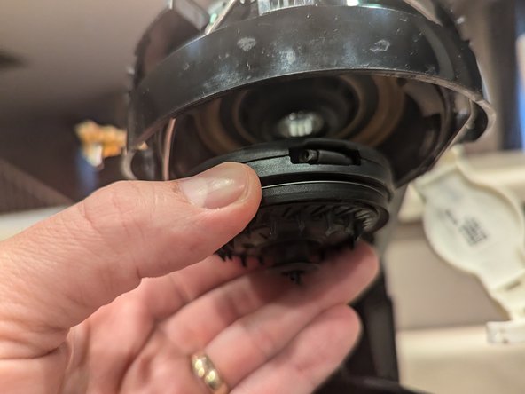

  10. Nespresso Vertuo Evoluo Bearing Replacement, Remove piercer head: crwdns2935265:011crwdnd2935265:01crwdnd2935265:03crwdne2935265:0 Nespresso Vertuo Evoluo Bearing Replacement, Remove piercer head: crwdns2935265:011crwdnd2935265:02crwdnd2935265:03crwdne2935265:0 Nespresso Vertuo Evoluo Bearing Replacement, Remove piercer head: crwdns2935265:011crwdnd2935265:03crwdnd2935265:03crwdne2935265:0
    • Re-open the lid by rotating the two lid-release pins (at 5 o'clock and 11 o'clock on the machine head) counter-clockwise.
    • With one hand under the machine head, carefully hold the piercer and keep it from rotating, while with the other hand unscrewing the plastic retaining nut from the top.
    • Gently push the threaded shaft down to remove the piercer assembly from the machine head.

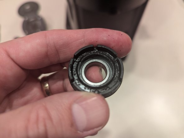

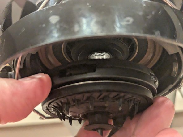

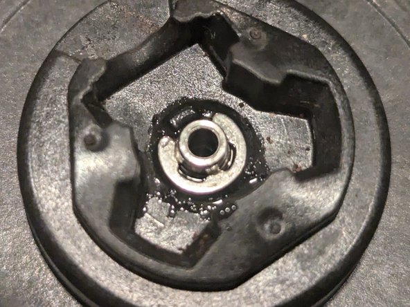

  11. Nespresso Vertuo Evoluo Bearing Replacement, Remove sealed bearing unit: crwdns2935265:012crwdnd2935265:01crwdnd2935265:03crwdne2935265:0 Nespresso Vertuo Evoluo Bearing Replacement, Remove sealed bearing unit: crwdns2935265:012crwdnd2935265:02crwdnd2935265:03crwdne2935265:0 Nespresso Vertuo Evoluo Bearing Replacement, Remove sealed bearing unit: crwdns2935265:012crwdnd2935265:03crwdnd2935265:03crwdne2935265:0
    • Gently push up from below the machine head to remove the bearing and the plastic bracket that holds it in place.

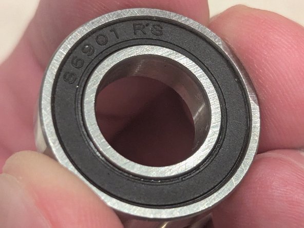

  12. Nespresso Vertuo Evoluo Bearing Replacement, New bearing & reassembly: crwdns2935265:013crwdnd2935265:01crwdnd2935265:02crwdne2935265:0 Nespresso Vertuo Evoluo Bearing Replacement, New bearing & reassembly: crwdns2935265:013crwdnd2935265:02crwdnd2935265:02crwdne2935265:0
    • Gently push the bearing out of the plastic bracket.
    • Clean and wipe the plastic bracket, then insert the new bearing into the bracket.

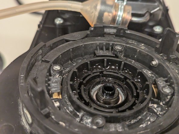

  13. Nespresso Vertuo Evoluo Bearing Replacement, Reinstall piercer head: crwdns2935265:014crwdnd2935265:01crwdnd2935265:03crwdne2935265:0 Nespresso Vertuo Evoluo Bearing Replacement, Reinstall piercer head: crwdns2935265:014crwdnd2935265:02crwdnd2935265:03crwdne2935265:0 Nespresso Vertuo Evoluo Bearing Replacement, Reinstall piercer head: crwdns2935265:014crwdnd2935265:03crwdnd2935265:03crwdne2935265:0
    • Clean the surface at the top of the machine head where the bearing will sit.
    • Gently press the bearing and plastic bracket back into place from the top of the machine head.
    • Clean any debris from the piercer head and the piercer head threaded shaft.
    • Carefully reinsert the piercer head threaded shaft through the hole in the bearing, and screw the plastic retaining nut back onto the piercer shaft.

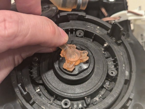

  14. Nespresso Vertuo Evoluo Bearing Replacement, Steamer lid and steam tube: crwdns2935265:015crwdnd2935265:01crwdnd2935265:03crwdne2935265:0 Nespresso Vertuo Evoluo Bearing Replacement, Steamer lid and steam tube: crwdns2935265:015crwdnd2935265:02crwdnd2935265:03crwdne2935265:0 Nespresso Vertuo Evoluo Bearing Replacement, Steamer lid and steam tube: crwdns2935265:015crwdnd2935265:03crwdnd2935265:03crwdne2935265:0
    • Close the machine lid.
    • Clean the tension spring and carefully place it on the top of the machine head.
    • Align the steamer lid on top of the spring so that the notch for the silicone tube to exit is pointing to the upper left (roughly 10 o'clock position; see photo 2).
    • Alignment of the metal tube in the end of the silicone tube is critical. If the metal tube has fallen out of the silicone tube, or if it has rotated within the silicone tube, it will be easiest to achieve proper alignment by removing the metal tube from the silicone tube and inserting it into the steamer lid.
    • Note the E-clip on the end of the metal tube. The gap in the E-clip must line up with a small post on the steamer lid. (see photo 3)
    • If you've re-assembled your machine but discover that you have weak or watery coffee, come back to this step and reconfirm that the metal tube is properly aligned. See this Reddit post for details.

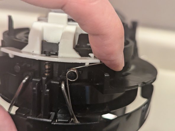

  17. Nespresso Vertuo Evoluo Bearing Replacement, Re-attach lid release spring: crwdns2935265:018crwdnd2935265:01crwdnd2935265:02crwdne2935265:0 Nespresso Vertuo Evoluo Bearing Replacement, Re-attach lid release spring: crwdns2935265:018crwdnd2935265:02crwdnd2935265:02crwdne2935265:0
    • Carefully re-attach the silver lid release spring.
    • It may be easiest to first attach one end of the spring to the black lid release post, then use tweezers or a toothpick to stretch the other end of the spring over the post on the white button bracket.
  18. Nespresso Vertuo Evoluo Bearing Replacement, Re-attach capsule catch bar springs: crwdns2935265:019crwdnd2935265:01crwdnd2935265:03crwdne2935265:0 Nespresso Vertuo Evoluo Bearing Replacement, Re-attach capsule catch bar springs: crwdns2935265:019crwdnd2935265:02crwdnd2935265:03crwdne2935265:0 Nespresso Vertuo Evoluo Bearing Replacement, Re-attach capsule catch bar springs: crwdns2935265:019crwdnd2935265:03crwdnd2935265:03crwdne2935265:0
    • Attach the lower end of each capsule catch bar spring to the catch bar, gently pressing it into place on the bar. (photo 1)
    • Slide the spring onto the round spring mount. (photo 2)
    • Gently bend the upper spring arm under the white button bracket, making sure the spring arm rests behind the plastic ridge to hold it in place. (photo 3)

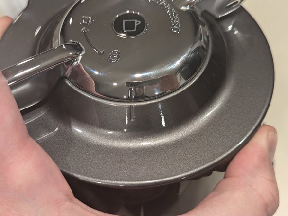

  19. Nespresso Vertuo Evoluo Bearing Replacement, Prepare to re-attach upper cover: crwdns2935265:020crwdnd2935265:01crwdnd2935265:02crwdne2935265:0 Nespresso Vertuo Evoluo Bearing Replacement, Prepare to re-attach upper cover: crwdns2935265:020crwdnd2935265:02crwdnd2935265:02crwdne2935265:0
    • The two posts on the steamer cover (ie, on the machine head) must align with two holes in the upper plastic cover so that the release handles on the top of the upper cover properly rotate and lock the steamer, when the upper cover is attached.
    • This alignment is easiest when the machine head is in the closed and locked position:
    • Close the machine head and rotate the steamer clockwise to the locked position. The posts will be at roughly 10 and 4 o'clock.
    • On the upper side of the upper cover, rotate the release handles until the "locked" indicator lines line up.

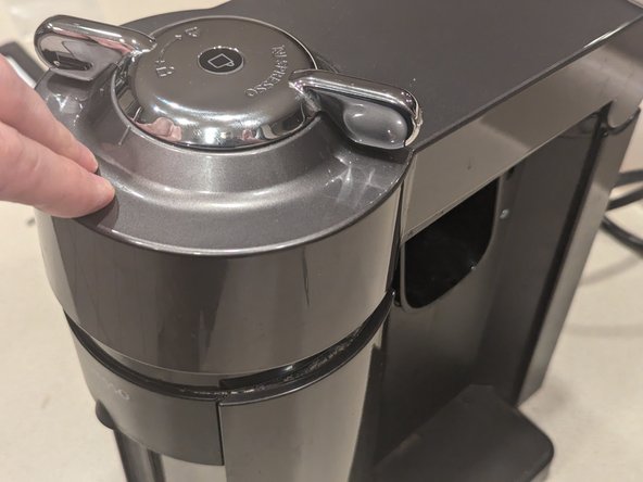

  20. Nespresso Vertuo Evoluo Bearing Replacement, Pressing the upper cover into place: crwdns2935265:021crwdnd2935265:01crwdnd2935265:02crwdne2935265:0 Nespresso Vertuo Evoluo Bearing Replacement, Pressing the upper cover into place: crwdns2935265:021crwdnd2935265:02crwdnd2935265:02crwdne2935265:0
    • Latch the back end of the upper plastic cover over the plastic tabs at the back of the machine. (photo 1)
    • Gently rotate the front of the lid down and press it into place, making sure that the posts on the upper steamer lid align with the holes on the lid. (photo 2)
    • You should be able to slightly rotate the upper locking handles and feel resistance as they engage the steamer head below them.
    • After pressing all the locking plastic tabs into place around the top of the machine lid, you should be able to open and close the machine lid using the locking handles.
  21. Nespresso Vertuo Evoluo Bearing Replacement, Re-fastening the upper cover screws: crwdns2935265:022crwdnd2935265:01crwdnd2935265:01crwdne2935265:0
    • Open the upper lid, and secure the upper lid in place by re-fastening the two T10 Torx screws.
    • A small flashlight may help to get the screws aligned and seated in the recessed openings.

I did this and the unit is still noisy. Sounds like the drive mechanism for the spinning parts. Once the drive stops, the spinning parts coast quietly down to zero revolutions. Cannot find any relevant info on further parts availability for VertuoLine Vertuo Flat Head machines let alone a parts breakdown.

Either way, great instructions. Replacing the bearing is like night and day for noise. The machine is so incredibly quiet again.

How is this not a recall?
What happens to the bearing debris, lube, rust, metal shards, shield chunks that end-up in the coffee while the bearing is falling apart, before it stops spinning completely?
I tried emailing them a few years ago when our first machine kicked the bucket and sent them pictures of the metal chunks, got no answer.
This is dangerous
