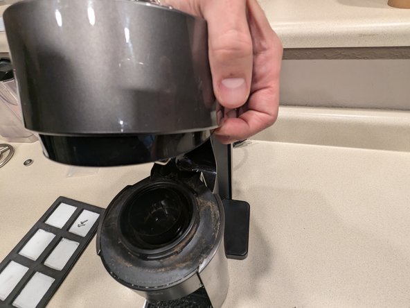

Remove upper cover
  • The upper plastic cover is also secured by several plastic catches. Beginning on one side near where the circular head portion of the lid meets the longer arm portion, GENTLY spread the bottom edge of the plastic cover out, so that the plastic catches at that point disengage.
  • Once one side has been freed, perform the same GENTLE speading on the other side. When all the plastic catches on the circular head portion have been disengaged, the upper plastic cover can be lifted and rotated free of the remaining catches on the longer arm portion.
