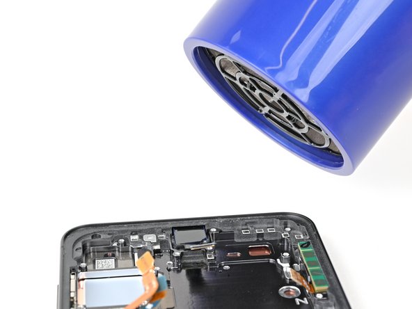

Samsung Galaxy S24 Screen and Battery Assembly Replacement, Heat the front camera: crwdns2935265:00crwdnd2935265:01crwdnd2935265:01crwdne2935265:0
  • The adhesive securing the camera is very strong. Work slowly and apply more heat if the camera feels stuck. Avoid separating the circuit board from camera housing, such as this.
  • Use a hair dryer or a heat gun to heat the front camera for 90 seconds.
