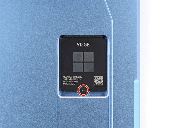

Microsoft Surface Pro 11 SSD Replacement, Remove the SSD screw: crwdns2935265:00crwdnd2935265:01crwdnd2935265:02crwdne2935265:0 Microsoft Surface Pro 11 SSD Replacement, Remove the SSD screw: crwdns2935265:00crwdnd2935265:02crwdnd2935265:02crwdne2935265:0
  • Use a Torx Plus 3IP screwdriver to remove the 2.4 mm‑long screw securing the SSD.
  • Removing the SSD also functions as a battery disconnect and should be done before all major repairs.
