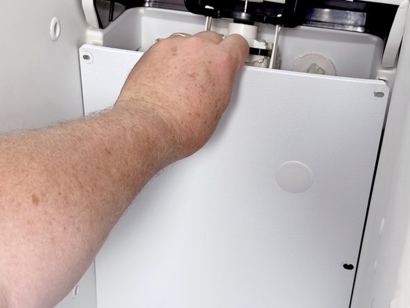

Frigidaire Side-By-Side Refrigerator Evaporator Fan Cover Removal, Remove the lower evaporator cover: crwdns2935265:00crwdnd2935265:01crwdnd2935265:03crwdne2935265:0 Frigidaire Side-By-Side Refrigerator Evaporator Fan Cover Removal, Remove the lower evaporator cover: crwdns2935265:00crwdnd2935265:02crwdnd2935265:03crwdne2935265:0 Frigidaire Side-By-Side Refrigerator Evaporator Fan Cover Removal, Remove the lower evaporator cover: crwdns2935265:00crwdnd2935265:03crwdnd2935265:03crwdne2935265:0
  • Lift the lower evaporator cover about 1/2" (13mm) to free it from the rear of the refrigerator.
  • Tilt the top of the lower evaporator cover toward the front of the fridge.
  • Remove the lower evaporator cover.
