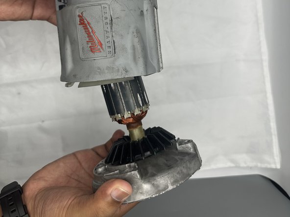

  • While holding the motor housing, pull out the service armature.
  • Putting your replacement service armature in can be tricky, but remember the spring at the bottom needs to be loaded.
