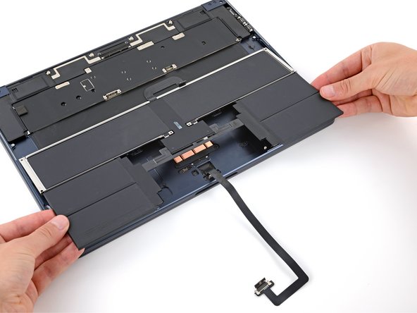

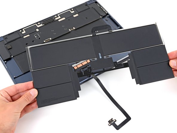

Remove the battery
  • Lift the battery and pull it towards the bottom of your laptop so the battery cable slides out from under the logic board.
  • Remove the battery.
  • During reassembly:
  • Remove any remaining adhesive from the frame and clean up the residue with a few drops of isopropyl alcohol and a microfiber cloth.
  • Before removing any adhesive liners, place the battery in its recess and make sure it fits.
  • When installing a new battery, make sure you slide its cable under the logic board before securing the battery.
  • If your replacement battery comes with adhesive, remove the plastic liners and firmly press each cell into place.
  • If your replacement battery doesn't come with adhesive, secure it with stretch-release adhesive or double-sided tape.
