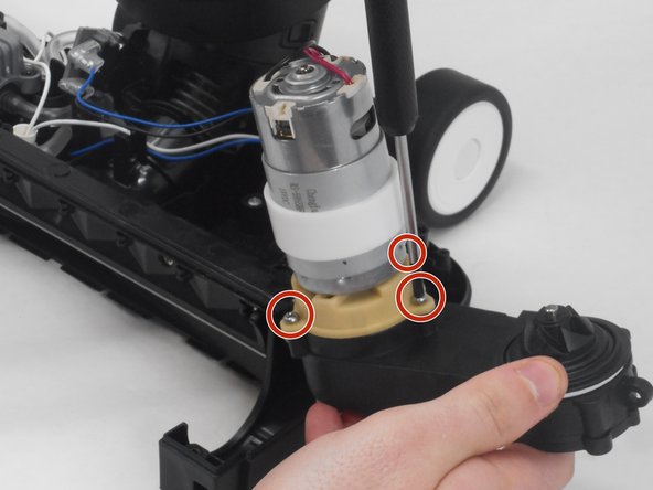

  • Remove three 10.56 mm screws from the gear with a Phillips #1 screwdriver.
