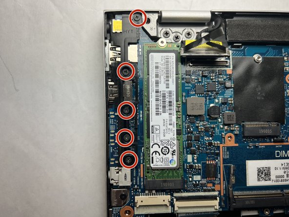

  • Use a Phillips #0 screwdriver to remove the five 4.1 mm screws from the plastic bracket.
  • Remove the bracket.
