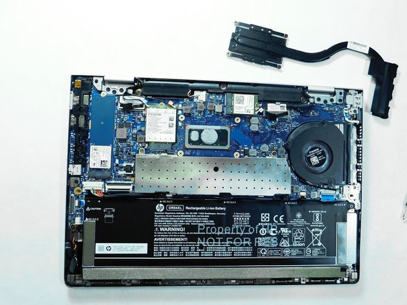

  6. HP EliteBook x360 830 G6 Motherboard Replacement, Unfasten the battery: crwdns2935265:06crwdnd2935265:01crwdnd2935265:01crwdne2935265:0
    • Use your Phillips screwdriver to remove the five 4.2 mm-long screws securing the battery.
  7. HP EliteBook x360 830 G6 Motherboard Replacement, Remove the battery: crwdns2935265:07crwdnd2935265:01crwdnd2935265:03crwdne2935265:0 HP EliteBook x360 830 G6 Motherboard Replacement, Remove the battery: crwdns2935265:07crwdnd2935265:02crwdnd2935265:03crwdne2935265:0 HP EliteBook x360 830 G6 Motherboard Replacement, Remove the battery: crwdns2935265:07crwdnd2935265:03crwdnd2935265:03crwdne2935265:0
    • Pull the battery out from the retaining tabs at the front of the chassis.
    • Remove the battery.

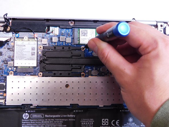

  14. HP EliteBook x360 830 G6 Motherboard Replacement, Cooling System: crwdns2935265:014crwdnd2935265:01crwdnd2935265:03crwdne2935265:0 HP EliteBook x360 830 G6 Motherboard Replacement, Cooling System: crwdns2935265:014crwdnd2935265:02crwdnd2935265:03crwdne2935265:0 HP EliteBook x360 830 G6 Motherboard Replacement, Cooling System: crwdns2935265:014crwdnd2935265:03crwdnd2935265:03crwdne2935265:0
    • Using the Phillips #0 screwdriver, remove the seven 3 mm screws from the cooling system.
  15. HP EliteBook x360 830 G6 Motherboard Replacement: crwdns2935265:015crwdnd2935265:01crwdnd2935265:03crwdne2935265:0 HP EliteBook x360 830 G6 Motherboard Replacement: crwdns2935265:015crwdnd2935265:02crwdnd2935265:03crwdne2935265:0 HP EliteBook x360 830 G6 Motherboard Replacement: crwdns2935265:015crwdnd2935265:03crwdnd2935265:03crwdne2935265:0

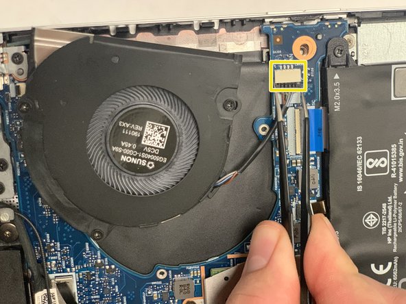

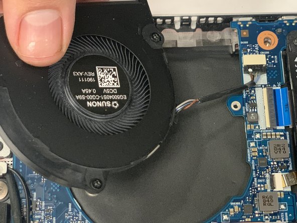

    • Remove the three 3mm captive screws from the fan using the Philips 0 screwdriver.
    • Using needle nose tweezers, gently grab the base of the connection and pull to disconnect.
  16. HP EliteBook x360 830 G6 Motherboard Replacement: crwdns2935265:016crwdnd2935265:01crwdnd2935265:01crwdne2935265:0
    • Separate the fan and cooling system from the motherboard.

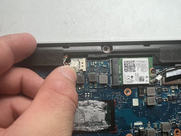

  17. HP EliteBook x360 830 G6 Motherboard Replacement, Wi-Fi Card: crwdns2935265:017crwdnd2935265:01crwdnd2935265:02crwdne2935265:0 HP EliteBook x360 830 G6 Motherboard Replacement, Wi-Fi Card: crwdns2935265:017crwdnd2935265:02crwdnd2935265:02crwdne2935265:0
    • Remove the two antenna cable with tweezers.
    • The blue tagged antenna will be on the left side. The red tagged antenna will be on the right side.
  18. HP EliteBook x360 830 G6 Motherboard Replacement: crwdns2935265:018crwdnd2935265:01crwdnd2935265:02crwdne2935265:0 HP EliteBook x360 830 G6 Motherboard Replacement: crwdns2935265:018crwdnd2935265:02crwdnd2935265:02crwdne2935265:0
    • Use a Phillips #0 screwdriver to remove the 3 mm screw securing the Wi-Fi card.
    • The card will pop up at a slight angle once the screw is removed.
  19. HP EliteBook x360 830 G6 Motherboard Replacement: crwdns2935265:019crwdnd2935265:01crwdnd2935265:02crwdne2935265:0 HP EliteBook x360 830 G6 Motherboard Replacement: crwdns2935265:019crwdnd2935265:02crwdnd2935265:02crwdne2935265:0
    • Grasp the sides of the Wi-Fi card to slide it out of the socket to remove.
    • Gently remove the Wi-Fi card. There is risk of damage to the socket if removed forcefully.

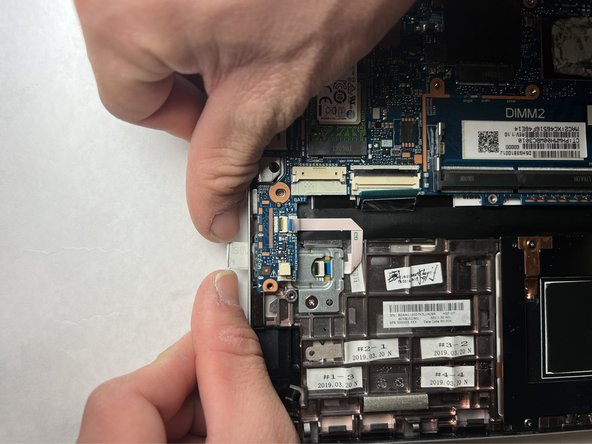

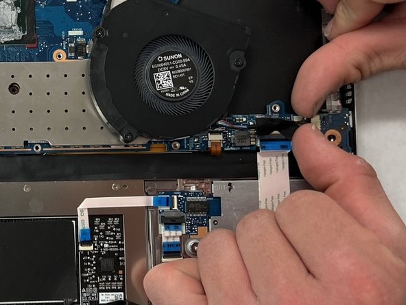

    • Remove each no-fuss ribbon connector by gently pulling the blue tab straight away from the port with your fingers.
    • To disconnect the ZIF connectors, use the tip of your fingernail to flip up the small locking flap. Then disconnect the ribbon cables.
    • Grab the black plastic loop of each of the connectors pull it upwards away from the motherboard.
    • When pulling out the ribbon, do not pull up and away from the laptop. Doing so may damage the ribbon or socket.

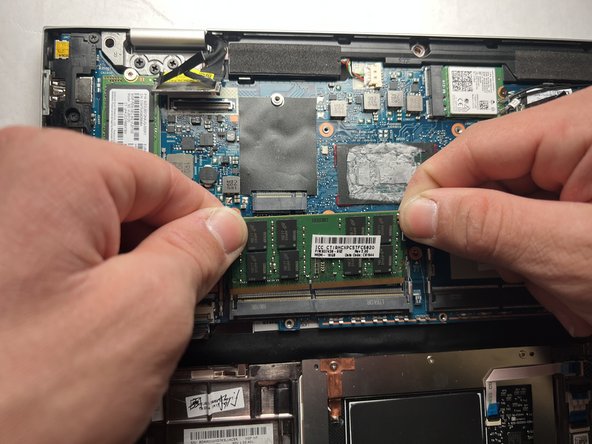

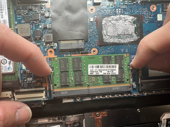

    • Remove the metal shield that covers the RAM module.
    • Gently pull the two silver retaining arms apart until the module flips up a few millimeters.
    • Remove the RAM module.
    • Pull the memory card straight back out of its slot to avoid damage to either part.

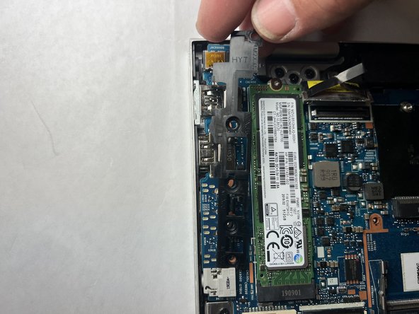

    • Push in then remove the SD card slot from the side of the laptop.
  24. HP EliteBook x360 830 G6 Motherboard Replacement: crwdns2935265:024crwdnd2935265:01crwdnd2935265:02crwdne2935265:0 HP EliteBook x360 830 G6 Motherboard Replacement: crwdns2935265:024crwdnd2935265:02crwdnd2935265:02crwdne2935265:0

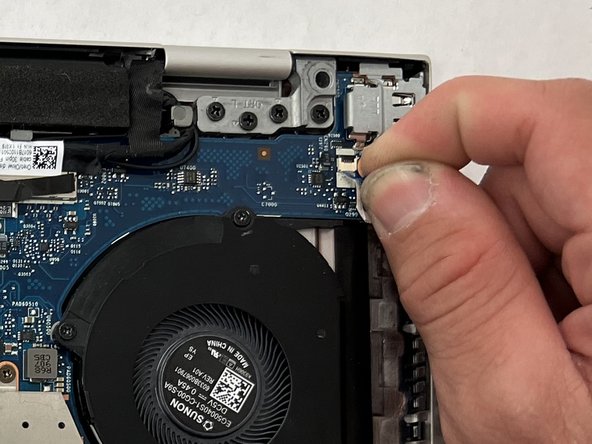

    • Remove the remaining cords connecting to the motherboard near the top.
  25. HP EliteBook x360 830 G6 Motherboard Replacement: crwdns2935265:025crwdnd2935265:01crwdnd2935265:02crwdne2935265:0 HP EliteBook x360 830 G6 Motherboard Replacement: crwdns2935265:025crwdnd2935265:02crwdnd2935265:02crwdne2935265:0

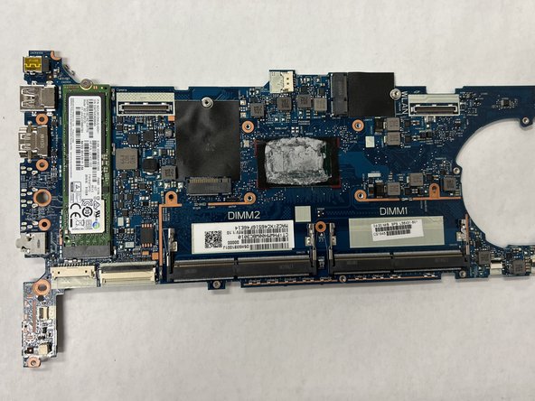

    • Gently lift and remove the motherboard.
    • Do not tug or forcefully pull the motherboard to remove it. If there is any significant resistance, double check that all previous steps were completed and all accessories are removed.
