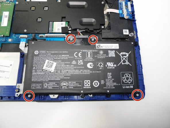

  • Using a Phillips #1 screwdriver remove the four 2.5 mm screws securing the battery in place.
  • To remove the battery, lift the battery slightly toward the bottom.
  • Pull the battery toward you.
  • Do not pull the battery straight up after the removal of the screws.
