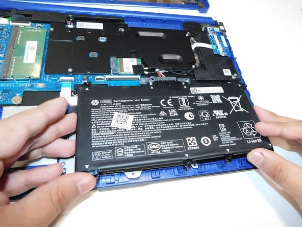

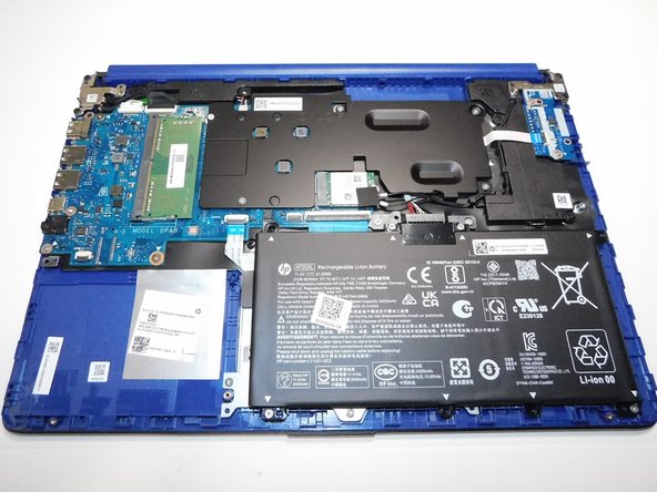

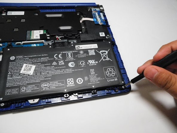

    • Using a Phillips #1 screwdriver remove the four 2.5 mm screws securing the battery in place.
    • To remove the battery, lift the battery slightly toward the bottom.
    • Pull the battery toward you.
    • Do not pull the battery straight up after the removal of the screws.
