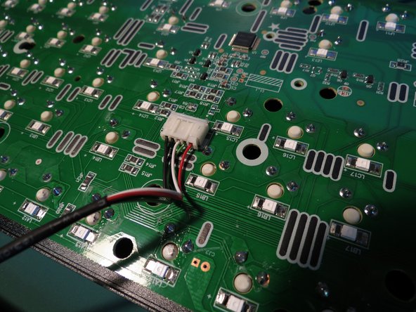

Disconnect power cable
  • The power cable is secured to the circuit board with a white connector
  • Use tweezers to carefully disconnect the connector
  • The connector may need to be shimmied side to side to be able to gently remove it
