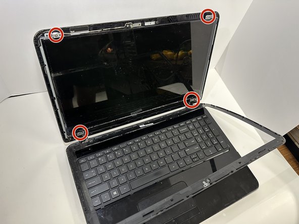

  • Use a Phillips screwdriver to remove the four 4 mm screws that secure the LCD panel.
