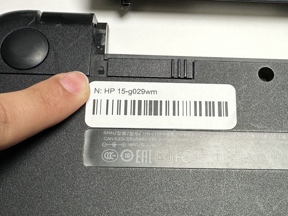

    • Unplug any charging cord or accessories connected to the device before beginning.
  2. HP 15-g029wm Screen Replacement: crwdns2935265:02crwdnd2935265:01crwdnd2935265:01crwdne2935265:0
    • Place the laptop bottom-side up on a secure, flat surface.
  3. HP 15-g029wm Screen Replacement: crwdns2935265:03crwdnd2935265:01crwdnd2935265:03crwdne2935265:0 HP 15-g029wm Screen Replacement: crwdns2935265:03crwdnd2935265:02crwdnd2935265:03crwdne2935265:0 HP 15-g029wm Screen Replacement: crwdns2935265:03crwdnd2935265:03crwdnd2935265:03crwdne2935265:0

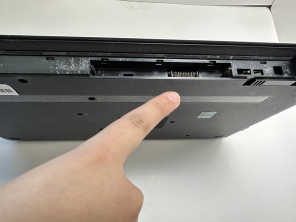

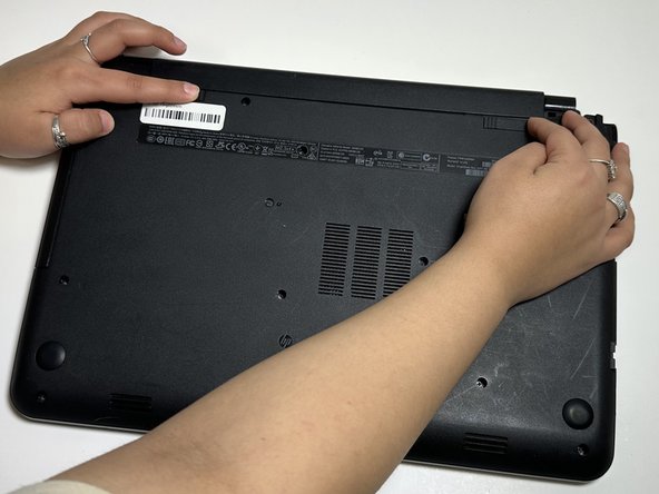

    • Slide each of the two switches that secure the battery to the left.
    • This will reveal an image of an unlocked lock.
  4. HP 15-g029wm Screen Replacement: crwdns2935265:04crwdnd2935265:01crwdnd2935265:03crwdne2935265:0 HP 15-g029wm Screen Replacement: crwdns2935265:04crwdnd2935265:02crwdnd2935265:03crwdne2935265:0 HP 15-g029wm Screen Replacement: crwdns2935265:04crwdnd2935265:03crwdnd2935265:03crwdne2935265:0

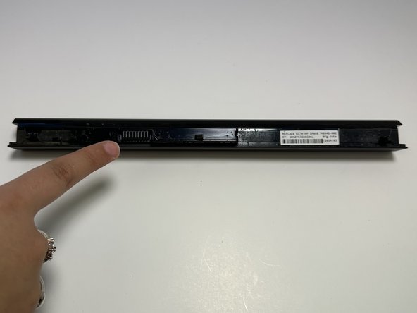

    • Use your hands to gently pull the disconnected battery out of the device.
    • When inserting the new battery, pay special attention to align the battery connections correctly.

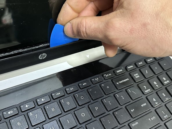

    • Insert an opening pick beneath the display bezel.
    • While periodically prying, slide the opening pick around the perimeter of the bezel to sever the adhesive.
  7. HP 15-g029wm Screen Replacement: crwdns2935265:07crwdnd2935265:01crwdnd2935265:01crwdne2935265:0
    • Once the majority of the adhesive is severed, use an opening pick or your hands to fully remove the bezel.

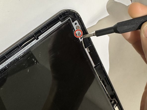

    • Use a Phillips screwdriver to remove the four 4 mm screws that secure the LCD panel.

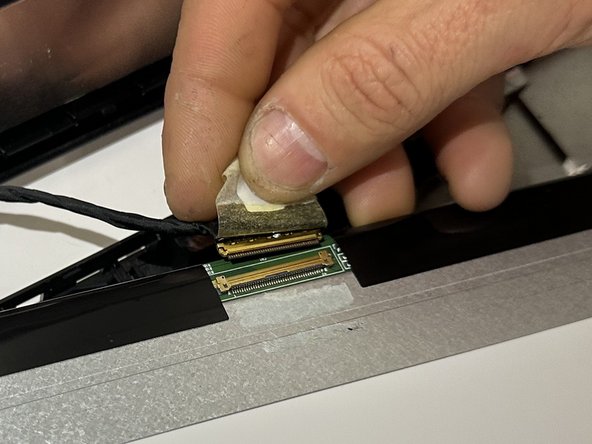

    • Gently peel up the tape over the display cable.
    • If there is a hinge, flip it up.
    • Remove the display cable.
