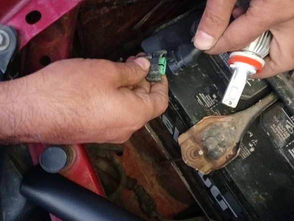

  • Now that the old bulb has been completely removed, you can move on to retracing your steps to insert the new bulb. You begin this process by connecting the new bulb's plug to the power cable's socket.
  • Just like in the previous step, hold down on the top of the socket with your thumb to lift the hook mechanism.
  • While holding the plug with your other hand, insert the plug into the socket, then let go of the top of the socket to secure both ends in place.
