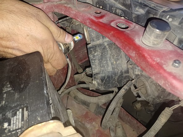

    • In order to replace the high-beam bulbs, you first need to know where they are located.
    • To find the left high-beam bulb, look between the inside of the left headlight and the car's windshield wiper fluid container.
    • To find the right high-beam bulb, look between the inside of the right headlight and the car's battery.
    • As you are about to see, this guide shows the replacement process of the right bulb for a 2017 Toyota Tacoma. This means that the engine may not look exactly the same as your vehicle's engine. If that's the case, a good rule of thumb to find the bulb is to use the headlight as a reference point. The bulb will always be located behind the headlight.

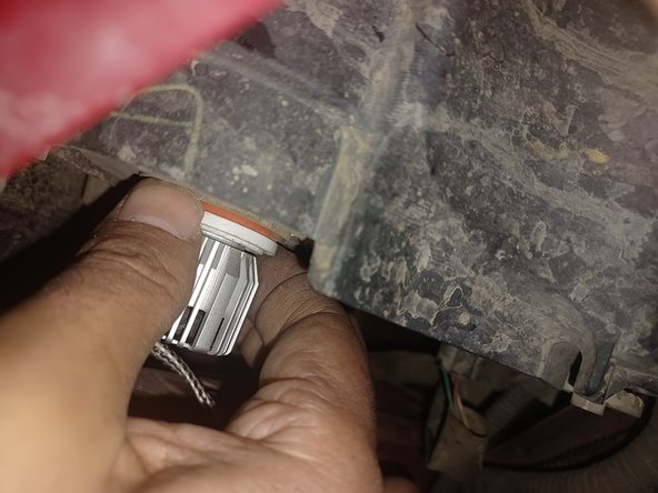

    • Now that we can access the high-beam bulb, we can begin the replacement process. The first step to replacing the bulb is to remove the old one from its socket.
    • Hold the bulb by the base and twist it clockwise to unhook its wedges from the socket.
    • Pull back the bulb while passing its wedges through their designated gaps until you see it fully out of the socket.

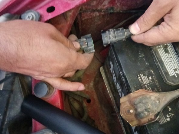

    • As you may have noticed already, the bulb is connected to its power cable via a plug. The next step will be to disconnect the bulb's plug from its socket.
    • Press down on the top of the socket with your thumb to release the hook mechanism that keeps the plug and the socket together.
    • While keeping the hook mechanism lifted, hold the plug with your other hand and separate the two ends apart from each other.

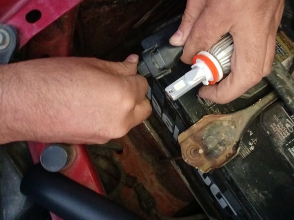

    • Now that the old bulb has been completely removed, you can move on to retracing your steps to insert the new bulb. You begin this process by connecting the new bulb's plug to the power cable's socket.
    • Just like in the previous step, hold down on the top of the socket with your thumb to lift the hook mechanism.
    • While holding the plug with your other hand, insert the plug into the socket, then let go of the top of the socket to secure both ends in place.
