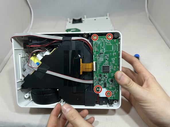

  • Remove the four 6.4 mm screws from the motherboard using a Phillips #1 screwdriver.
  • Pull back the motherboard to expose the connectors underneath.
