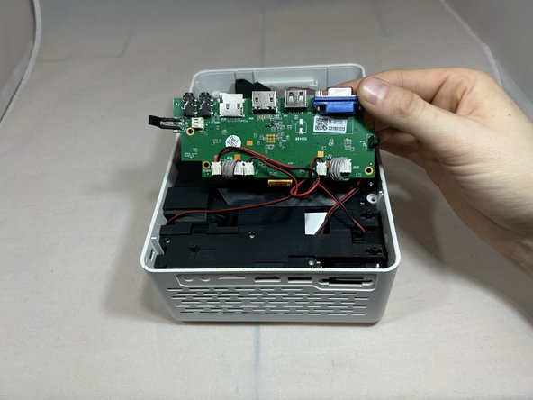

  3. TMY V08 Mirror Replacement, Mirror: crwdns2935265:03crwdnd2935265:01crwdnd2935265:02crwdne2935265:0 TMY V08 Mirror Replacement, Mirror: crwdns2935265:03crwdnd2935265:02crwdnd2935265:02crwdne2935265:0
    • Remove the four 6.4 mm screws from the motherboard using a Phillips #1 screwdriver.
    • Pull back the motherboard to expose the connectors underneath.

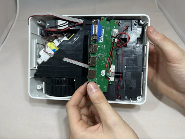

  4. TMY V08 Mirror Replacement: crwdns2935265:04crwdnd2935265:01crwdnd2935265:02crwdne2935265:0 TMY V08 Mirror Replacement: crwdns2935265:04crwdnd2935265:02crwdnd2935265:02crwdne2935265:0
    • Rotate the projector counterclockwise 90 degrees.
    • Disconnect the three bundled cable connectors and the two power cable connectors from the motherboard.

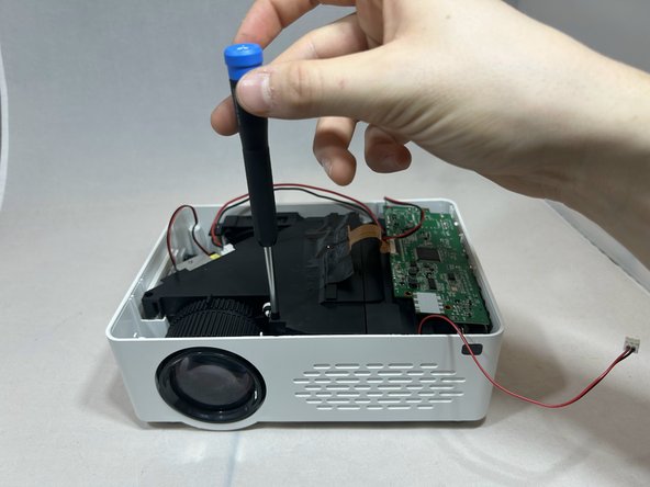

  5. TMY V08 Mirror Replacement: crwdns2935265:05crwdnd2935265:01crwdnd2935265:03crwdne2935265:0 TMY V08 Mirror Replacement: crwdns2935265:05crwdnd2935265:02crwdnd2935265:03crwdne2935265:0 TMY V08 Mirror Replacement: crwdns2935265:05crwdnd2935265:03crwdnd2935265:03crwdne2935265:0
    • Rotate the projector counter clockwise with the front facing you.
    • Remove the four 7.3 mm screws from the black cover to the left of the motherboard using a Phillips #1 screwdriver.
    • Remove the motherboard and black cover at the same time, being careful not to pull on the gold ribbon.

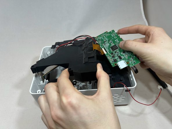

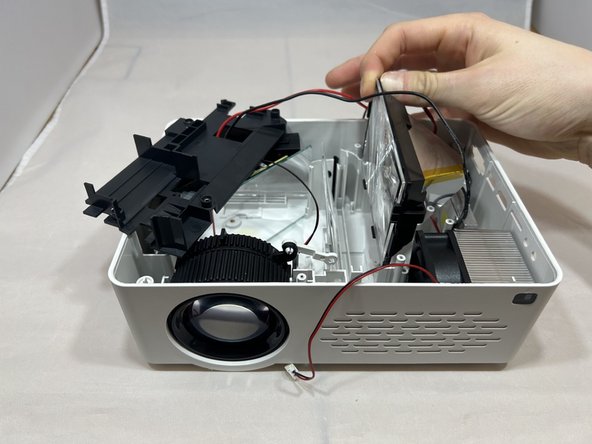

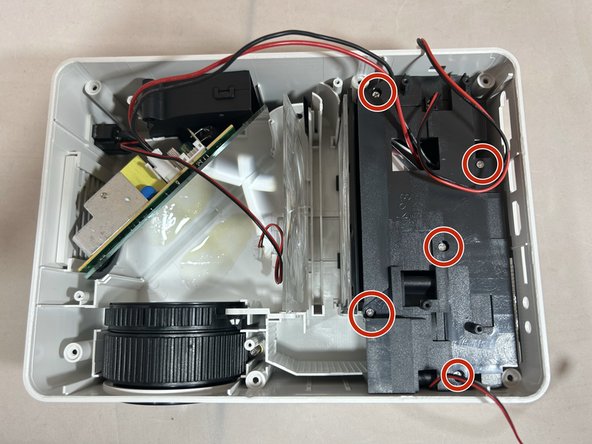

  6. TMY V08 Mirror Replacement: crwdns2935265:06crwdnd2935265:01crwdnd2935265:03crwdne2935265:0 TMY V08 Mirror Replacement: crwdns2935265:06crwdnd2935265:02crwdnd2935265:03crwdne2935265:0 TMY V08 Mirror Replacement: crwdns2935265:06crwdnd2935265:03crwdnd2935265:03crwdne2935265:0
    • Remove the five 7.3 mm screws from the black cover using a Phillips #1 screwdriver.
    • Take off the black cover to the right.

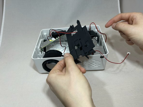

  7. TMY V08 Mirror Replacement: crwdns2935265:07crwdnd2935265:01crwdnd2935265:02crwdne2935265:0 TMY V08 Mirror Replacement: crwdns2935265:07crwdnd2935265:02crwdnd2935265:02crwdne2935265:0
    • Firmly grasp and lift the mirror and remove it from the projector.
