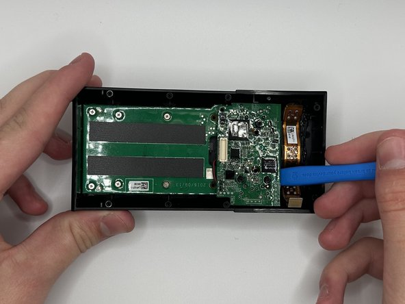

  • Pry the motherboard out with a plastic opening tool
  • Flip the device over and then carefully press on the camera lens to remove the camera and the attached mother board from the device.
