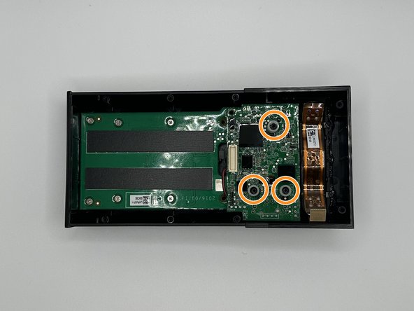

      • Remove the silver 5 mm Phillips #00 screw, and the two 10 mm Phillips #00 from the next motherboard.
      • Remove the 3 plastic spacers on the device.

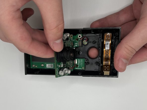

      • Pry the motherboard out with a plastic opening tool

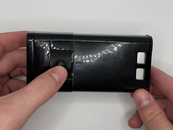

      • Flip the device over and then carefully press on the camera lens to remove the camera and the attached mother board from the device.
    10. Ring Outdoor Security Cam Microphone Replacement: crwdns2935265:010crwdnd2935265:01crwdnd2935265:01crwdne2935265:0
      • Remove the microphone.
