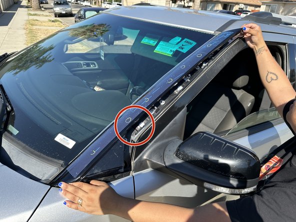

  • Align the small white head connections with the yellow points on the exterior trim, and then firmly snap the push tabs into place to secure the trim.
  • To guarantee a safe connection, gently press down after the white push tabs are aligned.
  • Remove the yellow markup sticker after inserting the tabs.
