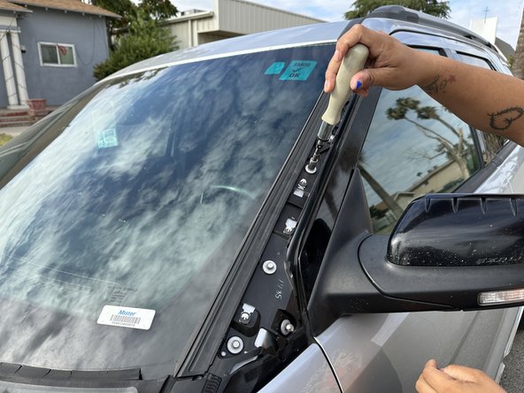

  • While maintaining downward pressure on the interior pillar trim, secure the six bolts into place.
  • Alternate one bolt at a time, bottom to top.
