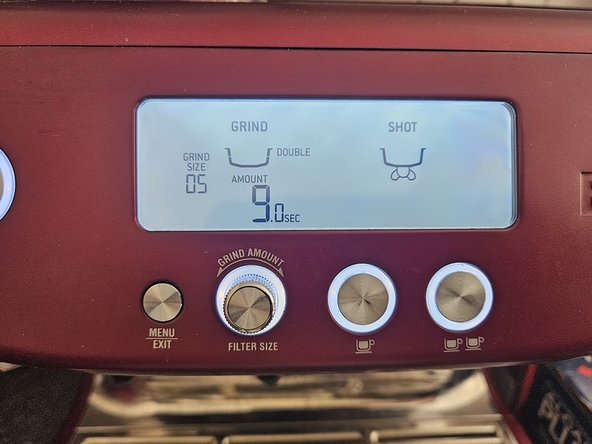

  • Once the rinse is complete, the grind amount option will appear on the display.
  • Rotate the right dial back to the neutral position.
