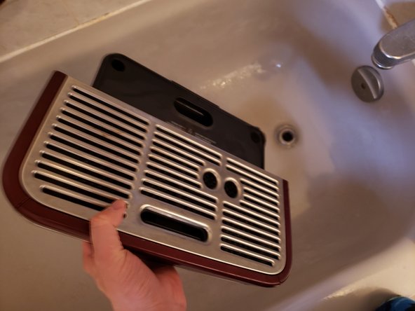

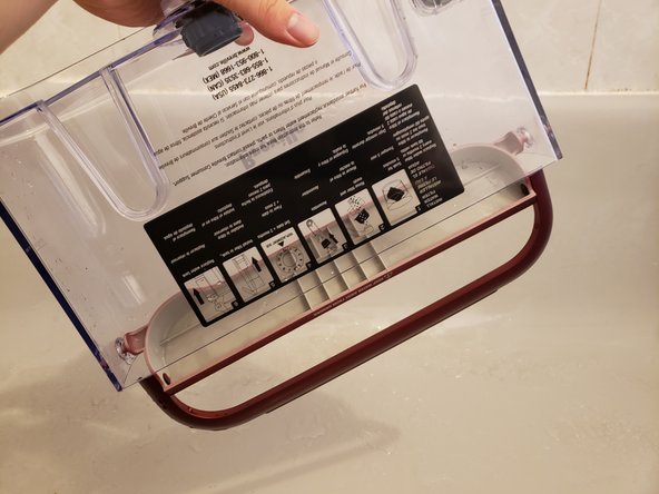

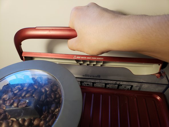

    • Pull out and empty the water tank and drip tray.
  3. How to Descale a Breville Barista Pro BES878-RVC: crwdns2935265:03crwdnd2935265:01crwdnd2935265:02crwdne2935265:0 How to Descale a Breville Barista Pro BES878-RVC: crwdns2935265:03crwdnd2935265:02crwdnd2935265:02crwdne2935265:0

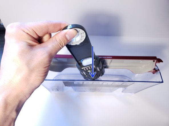

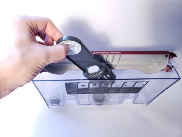

    • Pull out the water filter from the water tank.

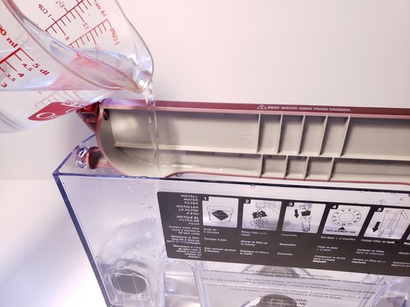

  4. How to Descale a Breville Barista Pro BES878-RVC: crwdns2935265:04crwdnd2935265:01crwdnd2935265:02crwdne2935265:0 How to Descale a Breville Barista Pro BES878-RVC: crwdns2935265:04crwdnd2935265:02crwdnd2935265:02crwdne2935265:0

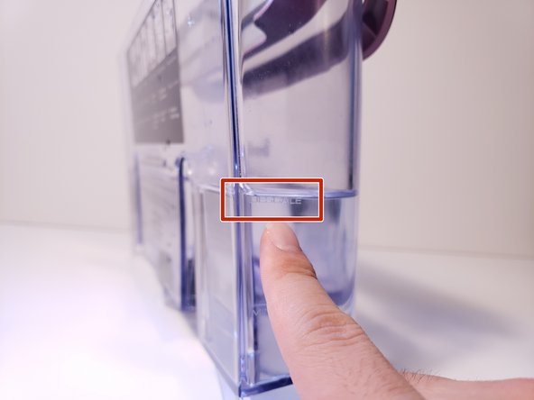

    • Pour a packet of descaler (or a descaler tablet) into the water tank.

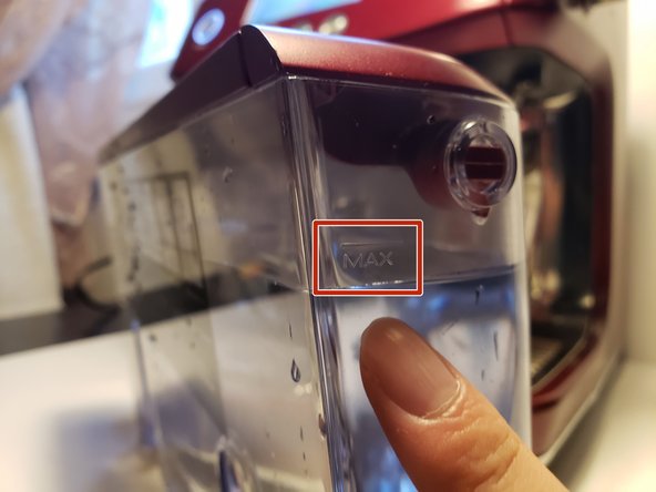

    • Fill the water tank with fresh water to the descale line located on the side of the water tank.
    • If you do not have a descaler, pour a 1:1 mixture of white vinegar and water into the water tank instead.

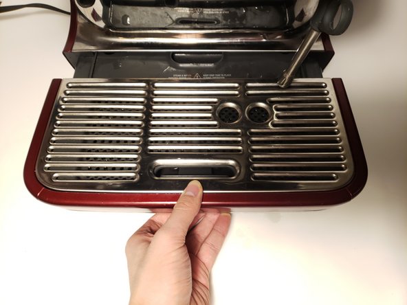

    • Reinsert water tank and drip tray.

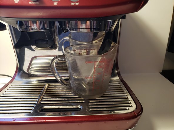

    • Position the steam wand above the drip tray.
    • If you wish to prevent splashing, place a tall bowl or cup under the steam wand.

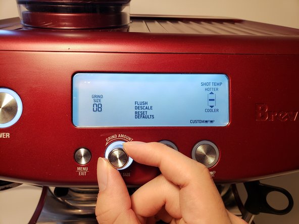

  7. How to Descale a Breville Barista Pro BES878-RVC: crwdns2935265:07crwdnd2935265:01crwdnd2935265:02crwdne2935265:0 How to Descale a Breville Barista Pro BES878-RVC: crwdns2935265:07crwdnd2935265:02crwdnd2935265:02crwdne2935265:0
    • Press the menu button.
    • Turn the knob labelled “Filter Size” counterclockwise until the “descale” label is blinking on the display.

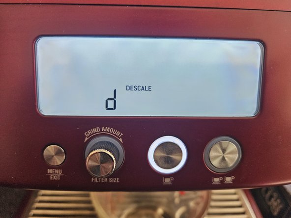

  8. How to Descale a Breville Barista Pro BES878-RVC: crwdns2935265:08crwdnd2935265:01crwdnd2935265:02crwdne2935265:0 How to Descale a Breville Barista Pro BES878-RVC: crwdns2935265:08crwdnd2935265:02crwdnd2935265:02crwdne2935265:0
    • Press down on the “Filter Size” knob to select descale.
    • The letter d will appear on the display and the one cup button will illuminate.
  9. How to Descale a Breville Barista Pro BES878-RVC: crwdns2935265:09crwdnd2935265:01crwdnd2935265:02crwdne2935265:0 How to Descale a Breville Barista Pro BES878-RVC: crwdns2935265:09crwdnd2935265:02crwdnd2935265:02crwdne2935265:0

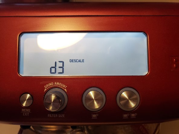

    • Press the one cup button to enter descale mode.
    • d3 will appear on the display and water will pour from the group head.

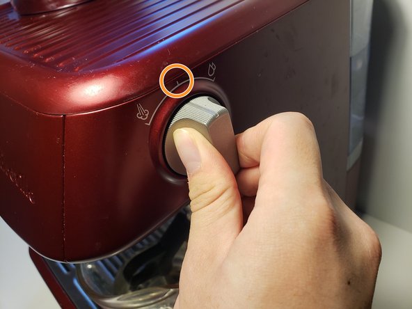

    • Wait for the display to show “d2.”

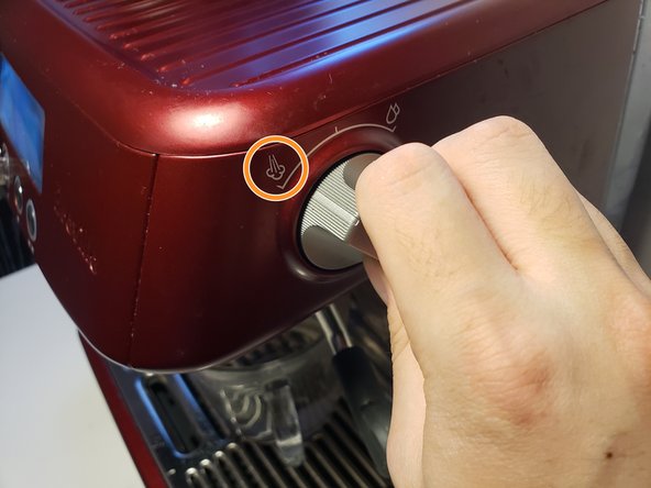

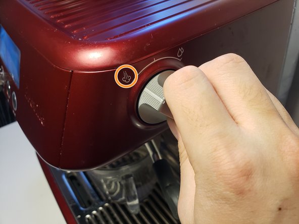

    • Rotate the right dial to the hot water icon to descale the hot water dispenser.
  11. How to Descale a Breville Barista Pro BES878-RVC: crwdns2935265:011crwdnd2935265:01crwdnd2935265:02crwdne2935265:0 How to Descale a Breville Barista Pro BES878-RVC: crwdns2935265:011crwdnd2935265:02crwdnd2935265:02crwdne2935265:0
    • Wait for the display to show “d1.”
    • Rotate the right dial to the steam icon to descale the steam wand.

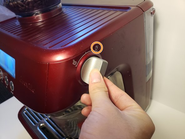

    • Wait for the display to show “r.”
    • Rotate the right dial back to the neutral position.
    • r means "rinse." You are now in the rinsing phase of descaling your espresso machine.

    • Pull out and empty the water tank.
    • Fill the water tank with fresh water to the max line.

    • Pull out the drip tray.
    • Empty the drip tray.
    • Reinsert the drip tray.

    • Pull out the water tank.
    • Reinsert the water filter.
    • Refill the water tank with fresh water.
