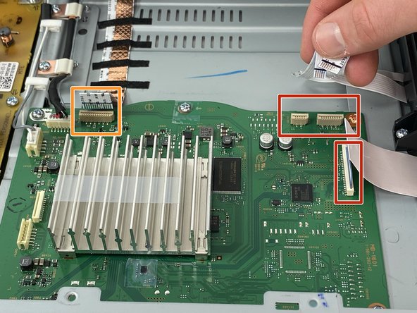

  • Remove the four ribbon connections running to the motherboard:
  • Remove the three ribbon cables from the disk drive by pulling straight up.
  • Remove one ribbon cable from the front panel by pulling straight up.
