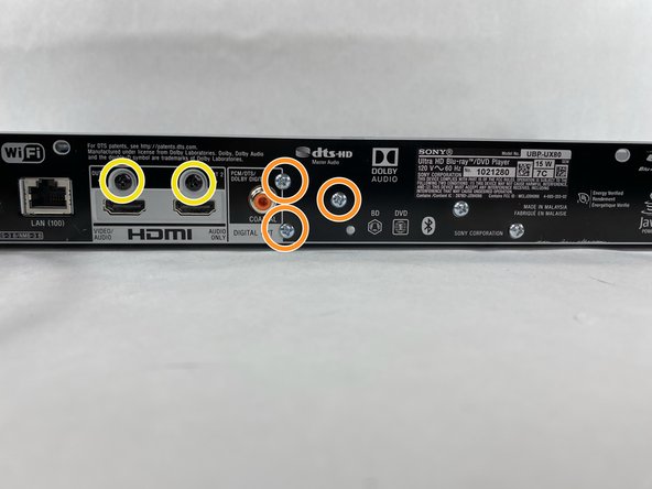

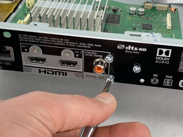

  7. Sony UBP-UX80 Motherboard Replacement: crwdns2935265:07crwdnd2935265:01crwdnd2935265:03crwdne2935265:0 Sony UBP-UX80 Motherboard Replacement: crwdns2935265:07crwdnd2935265:02crwdnd2935265:03crwdne2935265:0 Sony UBP-UX80 Motherboard Replacement: crwdns2935265:07crwdnd2935265:03crwdnd2935265:03crwdne2935265:0
    • Use a Phillips #2 screwdriver to remove the seven 10.5 mm screws that secure the motherboard to the case.
    • Remove the three 10.5 mm silver screws from the back of the case.
    • Remove the two 7 mm black screws from the back of the case.

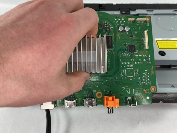

  8. Sony UBP-UX80 Motherboard Replacement: crwdns2935265:08crwdnd2935265:01crwdnd2935265:02crwdne2935265:0 Sony UBP-UX80 Motherboard Replacement: crwdns2935265:08crwdnd2935265:02crwdnd2935265:02crwdne2935265:0
    • Lift the front of the motherboard using the heat sink, slide forward and out of the case.
