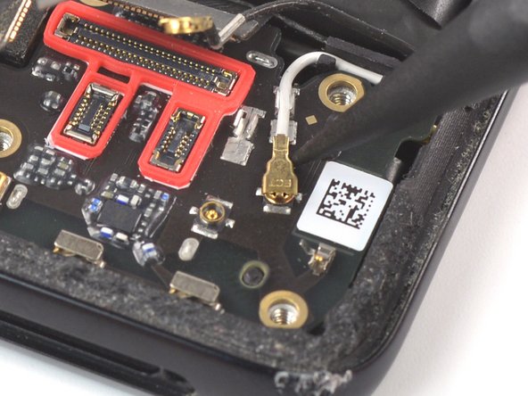

OnePlus 8 Daughterboard Replacement, Disconnect and unclip the white antenna cable: crwdns2935265:00crwdnd2935265:01crwdnd2935265:03crwdne2935265:0 OnePlus 8 Daughterboard Replacement, Disconnect and unclip the white antenna cable: crwdns2935265:00crwdnd2935265:02crwdnd2935265:03crwdne2935265:0 OnePlus 8 Daughterboard Replacement, Disconnect and unclip the white antenna cable: crwdns2935265:00crwdnd2935265:03crwdnd2935265:03crwdne2935265:0
  • Use the pointed end of a spudger to disconnect the white antenna cable by prying the connector straight up from its socket on the motherboard.
  • Use a pair of tweezers or your fingers to lift the white antenna cable out of its clip on the daughterboard.
  • During reassembly, make sure the antenna cables are pushed into their channels on the right edge of the phone before pressing them into their respective clips.
