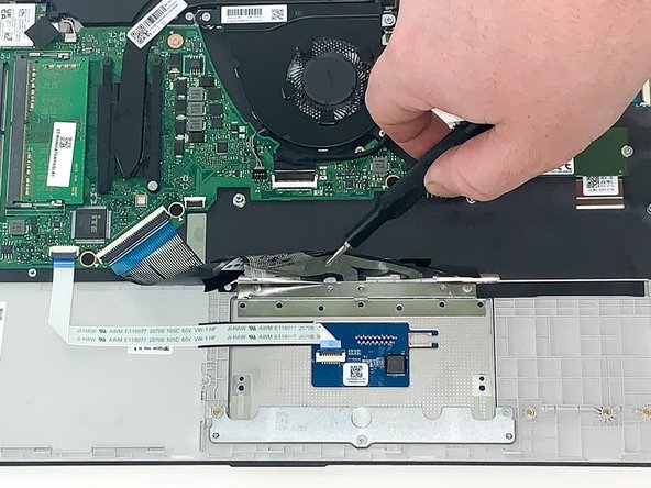

  • Use tweezers to flip up the ZIF connector locking flap.
  • Use tweezers to disconnect the ribbon cable from the back of the track pad.
