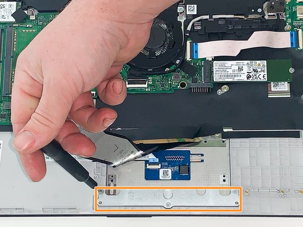

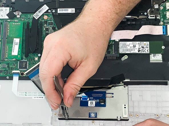

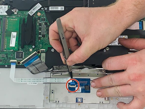

  6. HP 15-ef2025nr Trackpad Replacement, Trackpad: crwdns2935265:06crwdnd2935265:01crwdnd2935265:02crwdne2935265:0 HP 15-ef2025nr Trackpad Replacement, Trackpad: crwdns2935265:06crwdnd2935265:02crwdnd2935265:02crwdne2935265:0
    • Use tweezers to flip up the ZIF connector locking flap.
    • Use tweezers to disconnect the ribbon cable from the back of the track pad.
  7. HP 15-ef2025nr Trackpad Replacement: crwdns2935265:07crwdnd2935265:01crwdnd2935265:03crwdne2935265:0 HP 15-ef2025nr Trackpad Replacement: crwdns2935265:07crwdnd2935265:02crwdnd2935265:03crwdne2935265:0 HP 15-ef2025nr Trackpad Replacement: crwdns2935265:07crwdnd2935265:03crwdnd2935265:03crwdne2935265:0
    • Remove the six 2 mm Phillips screws securing the trackpad.
    • Remove the retaining plate from the bottom of the track pad.
    • Remove the track pad.
