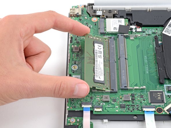

HP 15-dy RAM Replacement, Remove the RAM: crwdns2935265:00crwdnd2935265:01crwdnd2935265:02crwdne2935265:0 HP 15-dy RAM Replacement, Remove the RAM: crwdns2935265:00crwdnd2935265:02crwdnd2935265:02crwdne2935265:0
Remove the RAM
  • Pull the stick of RAM out of its socket to remove it.
  • Repeat for a second stick of RAM.
  • To install a memory module, insert it into its socket at a slight downward angle, then push down firmly until both metal arms lock the RAM in place.
