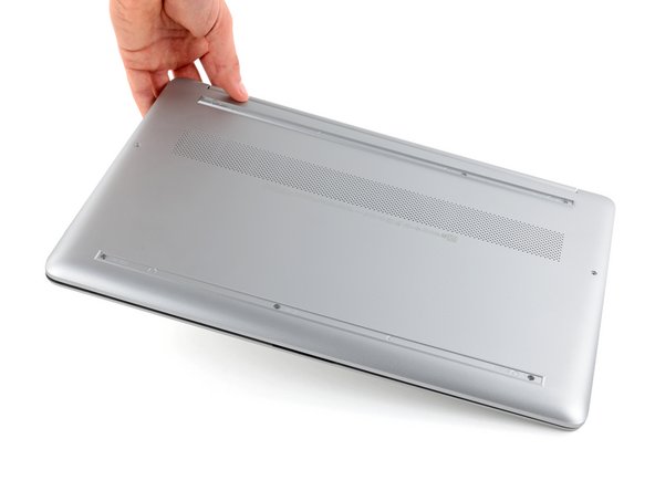

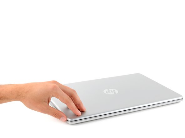

      • Fully shut down your laptop and unplug all cables.
    1. HP 15-dy RAM Replacement, Flip your laptop over: crwdns2935265:02crwdnd2935265:01crwdnd2935265:01crwdne2935265:0
      • Flip your laptop over so the rubber feet are facing up.

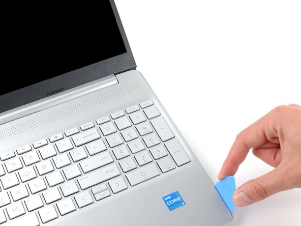

    2. HP 15-dy RAM Replacement, Peel up an end of the front foot: crwdns2935265:03crwdnd2935265:01crwdnd2935265:03crwdne2935265:0 HP 15-dy RAM Replacement, Peel up an end of the front foot: crwdns2935265:03crwdnd2935265:02crwdnd2935265:03crwdne2935265:0 HP 15-dy RAM Replacement, Peel up an end of the front foot: crwdns2935265:03crwdnd2935265:03crwdnd2935265:03crwdne2935265:0
      • The rubber feet cover a total of six back cover screws.
      • Use an opening pick to peel up an end of the front rubber foot until you can grip it with your fingers.
      • Make sure both the foot and its adhesive peel up together, as they need to be removed as one piece.

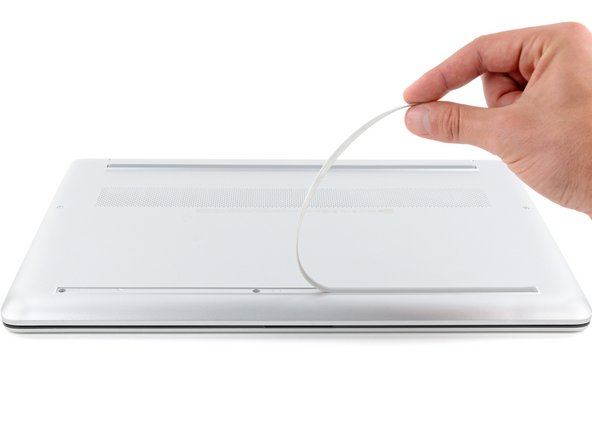

    3. HP 15-dy RAM Replacement, Remove the front foot: crwdns2935265:04crwdnd2935265:01crwdnd2935265:03crwdne2935265:0 HP 15-dy RAM Replacement, Remove the front foot: crwdns2935265:04crwdnd2935265:02crwdnd2935265:03crwdne2935265:0 HP 15-dy RAM Replacement, Remove the front foot: crwdns2935265:04crwdnd2935265:03crwdnd2935265:03crwdne2935265:0
      • Peel the front foot away from the back cover and remove it.

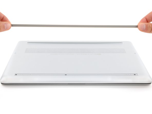

    4. HP 15-dy RAM Replacement, Remove the rear foot: crwdns2935265:05crwdnd2935265:01crwdnd2935265:03crwdne2935265:0 HP 15-dy RAM Replacement, Remove the rear foot: crwdns2935265:05crwdnd2935265:02crwdnd2935265:03crwdne2935265:0 HP 15-dy RAM Replacement, Remove the rear foot: crwdns2935265:05crwdnd2935265:03crwdnd2935265:03crwdne2935265:0
      • Use an opening pick to peel up an end of the rear rubber foot until you can grip it with your fingers.
      • Peel the rear foot away from the back cover and remove it.

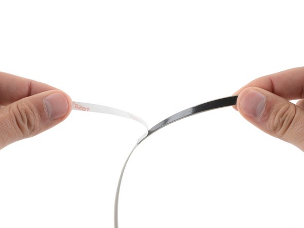

    5. HP 15-dy RAM Replacement, Reassembly information: crwdns2935265:06crwdnd2935265:01crwdnd2935265:03crwdne2935265:0 HP 15-dy RAM Replacement, Reassembly information: crwdns2935265:06crwdnd2935265:02crwdnd2935265:03crwdne2935265:0 HP 15-dy RAM Replacement, Reassembly information: crwdns2935265:06crwdnd2935265:03crwdnd2935265:03crwdne2935265:0
      Tesa 61395 Tape
      $8.95
      • Note that the rubber feet are different:
      • The rear foot is thicker, with a deeper recess.
      • The front foot is thinner, with a shallower recess.
      • During reassembly:
      • If you're reusing the rubber feet, the leftover adhesive should be tacky enough to reuse.
      • If the leftover adhesive isn't sticky enough or your replacement feet didn't come with adhesive, you can use double-sided tape such as Tesa Tape to secure the feet.
      • Make sure the strips of tape aren't wider than 6 mm, otherwise they may not fit.
      • To install a foot, remove its adhesive liner, lay the foot into its matching recess, and press down firmly along the entire length of the foot to secure it.

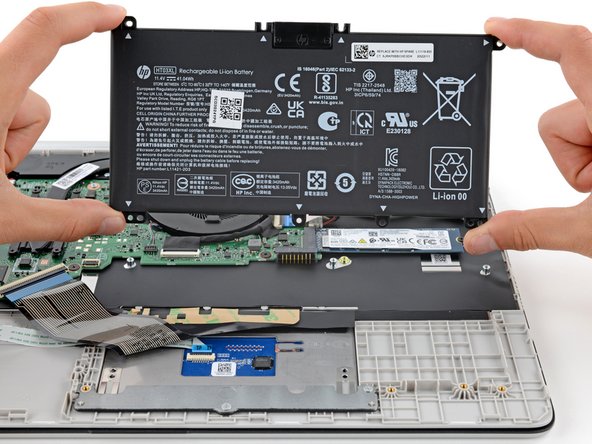

    1. HP 15-dy RAM Replacement, Unfasten the battery: crwdns2935265:014crwdnd2935265:01crwdnd2935265:02crwdne2935265:0 HP 15-dy RAM Replacement, Unfasten the battery: crwdns2935265:014crwdnd2935265:02crwdnd2935265:02crwdne2935265:0
      • Given the design of the battery connector, the only way to disconnect the battery is to physically remove it.
      • Try not to bend, crease, deform, poke, or puncture the battery with your tool—a damaged battery is a potential fire hazard.
      • Use a Phillips screwdriver to remove the five 3.7 mm-long screws securing the battery.
    2. HP 15-dy RAM Replacement, Remove the battery: crwdns2935265:015crwdnd2935265:01crwdnd2935265:03crwdne2935265:0 HP 15-dy RAM Replacement, Remove the battery: crwdns2935265:015crwdnd2935265:02crwdnd2935265:03crwdne2935265:0 HP 15-dy RAM Replacement, Remove the battery: crwdns2935265:015crwdnd2935265:03crwdnd2935265:03crwdne2935265:0
      • Gently lift the upper edge of the battery to disconnect its socket from the motherboard.
      • Remove the battery.
      • During reassembly, use the alignment posts to position the battery and press down on the socket to secure it.
      • Never reuse a deformed or damaged battery—it's a fire hazard. Replace it with a new battery.

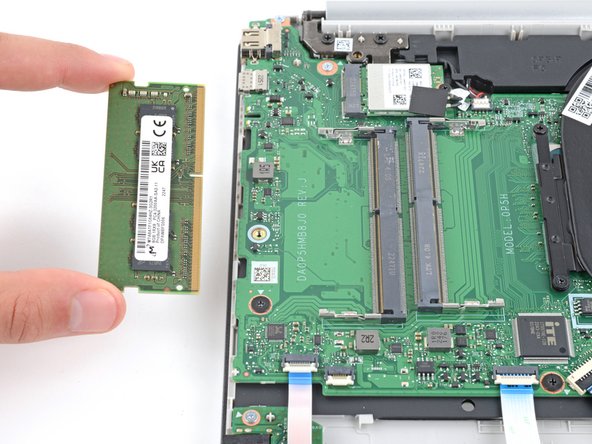

    1. HP 15-dy RAM Replacement, Unlatch the RAM: crwdns2935265:016crwdnd2935265:01crwdnd2935265:03crwdne2935265:0 HP 15-dy RAM Replacement, Unlatch the RAM: crwdns2935265:016crwdnd2935265:02crwdnd2935265:03crwdne2935265:0 HP 15-dy RAM Replacement, Unlatch the RAM: crwdns2935265:016crwdnd2935265:03crwdnd2935265:03crwdne2935265:0
      • Your laptop has two memory slots, each with a pair of metal arms that secure a stick of RAM.
      • Simultaneously push out the metal arms on each side of a stick of RAM until they disengage and the stick pops up at a slight angle.
    2. HP 15-dy RAM Replacement, Remove the RAM: crwdns2935265:017crwdnd2935265:01crwdnd2935265:02crwdne2935265:0 HP 15-dy RAM Replacement, Remove the RAM: crwdns2935265:017crwdnd2935265:02crwdnd2935265:02crwdne2935265:0
      • Pull the stick of RAM out of its socket to remove it.
      • Repeat for a second stick of RAM.
      • To install a memory module, insert it into its socket at a slight downward angle, then push down firmly until both metal arms lock the RAM in place.
