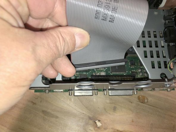

  • No lock on it but it is a 50 pin cable and it is rigid. Takes a bit of force to pull it straight up
  • The reason for the SCSI HDD Cable removal is the logic board power cable
  • To remove it, simply push on the tab and pull it straight up
