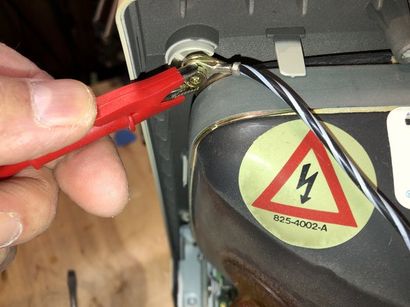

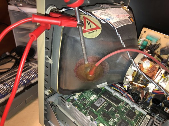

    • Here is the 9"CRT that we are going to discharge first You are dealing with some High Voltages. Use the proper precaution as outlined in the beginning of this guide
    • Ground screw
    • Anode Cap

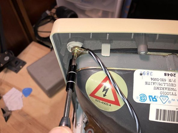

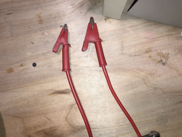

    • I use a test lead I had which has Alligator clips or either end. Worked perfect for this. A piece of insulated electrical wire 18 gauge AWG (or similar) will work for this as well.

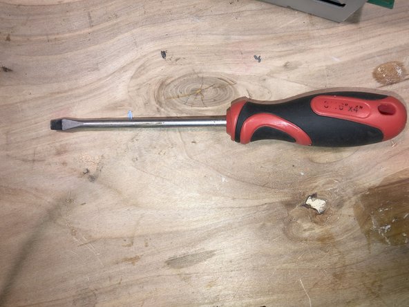

    • Next is a Flat Tip screwdriver that must italic texthave an insulated handle. No substitution allowed!
  7. Macintosh Classic II Power Board Removal: crwdns2935265:07crwdnd2935265:01crwdnd2935265:03crwdne2935265:0 Macintosh Classic II Power Board Removal: crwdns2935265:07crwdnd2935265:02crwdnd2935265:03crwdne2935265:0 Macintosh Classic II Power Board Removal: crwdns2935265:07crwdnd2935265:03crwdnd2935265:03crwdne2935265:0
    • Connect one end of the electrical wire to the flat tip screwdriver
    • Connect the other end of the wire to the grounding screw

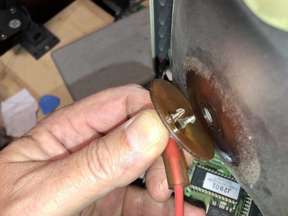

    • Using one hand only (place the other one in your pocket or behind your back) and the other not anywhere near the chassis, move the screwdriver behind the rubber shield of the Anode Cap. Slide it down until it touches the metal of the Anode. If your CRT was charged, you should now hear a "cracking" sound.
    • Not the sound of an explosion or anything as climactic, but definitely a cracking sound. If your CRT was discharged, maybe because it was unplugged for a awhile etc., you will not hear anything.
  8. Macintosh Classic II Power Board Removal: crwdns2935265:08crwdnd2935265:01crwdnd2935265:01crwdne2935265:0
    • I susually make sure that the screwdriver did touch the metal and using the same precautions as before, move it on the metal for the Anode. Just to ensure it did make proper contact. Usually I wait a minute or two before withdrawing the tool.
    • The CRT is now discharged.

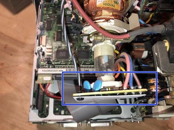

    • Here is the video board
    • Remove the T15 ground screw
  10. Macintosh Classic II Power Board Removal: crwdns2935265:010crwdnd2935265:01crwdnd2935265:03crwdne2935265:0 Macintosh Classic II Power Board Removal: crwdns2935265:010crwdnd2935265:02crwdnd2935265:03crwdne2935265:0 Macintosh Classic II Power Board Removal: crwdns2935265:010crwdnd2935265:03crwdnd2935265:03crwdne2935265:0
    • To rmove teh video board, pull it stright back. tehre might be some glue/sealant type that you need to remove first. This is different from computer to computer. So, check for that before just pulling on it. Should this be on your computer, carefully use a sharp blade to cut that sealant.
    • One point to be aware of is that under teh video board, is teh weakest point of your CRT. That is the glass niipple that was essnetial for creating this vacuum tube. It is a real weak spot. Should you damage it, air will enter your CRT and it will be permanently damaged. So, be mindful of it when you work on your computer.

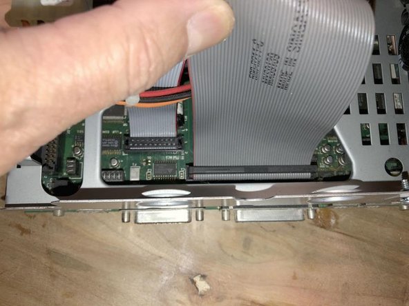

    • Next is the SCSI HDD Ribbon cable which needs to be removed.
  11. Macintosh Classic II Power Board Removal: crwdns2935265:011crwdnd2935265:01crwdnd2935265:03crwdne2935265:0 Macintosh Classic II Power Board Removal: crwdns2935265:011crwdnd2935265:02crwdnd2935265:03crwdne2935265:0 Macintosh Classic II Power Board Removal: crwdns2935265:011crwdnd2935265:03crwdnd2935265:03crwdne2935265:0
    • No lock on it but it is a 50 pin cable and it is rigid. Takes a bit of force to pull it straight up

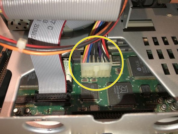

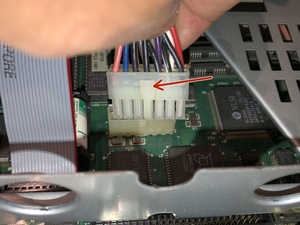

    • The reason for the SCSI HDD Cable removal is the logic board power cable
    • To remove it, simply push on the tab and pull it straight up

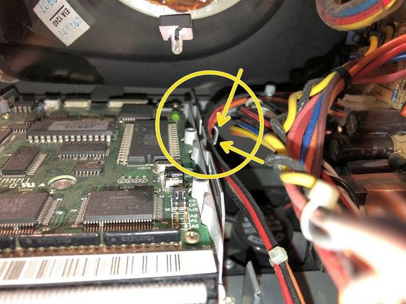

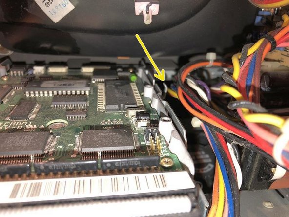

    • On the HDD caddy is a metal clip that functions as a wire holder for the logic board power cable.
    • Bend it slightly away from the caddy to free the wire

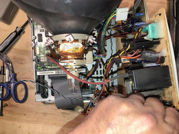

    • One more cable to be removed is the Yoke cable
    • Simply pulling on it will remove it. No lock on this

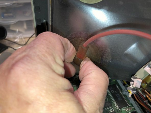

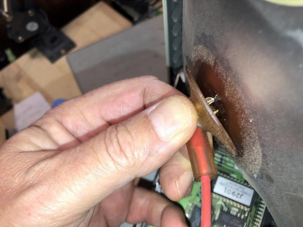

    • Now its time to remove the Anode. Grab it firmly
  14. Macintosh Classic II Power Board Removal: crwdns2935265:014crwdnd2935265:01crwdnd2935265:03crwdne2935265:0 Macintosh Classic II Power Board Removal: crwdns2935265:014crwdnd2935265:02crwdnd2935265:03crwdne2935265:0 Macintosh Classic II Power Board Removal: crwdns2935265:014crwdnd2935265:03crwdnd2935265:03crwdne2935265:0
    • and squeeze (lots of force with your thumb downward. That should free up the top notch
    • As you are squeezing and freeing to top notch, tilt the wire at an angle downward
    • and then lift it out. It does take considerable force to squeeze that wire. Do not use any pliers etc, since that may damage the insulation. That may lead to shocking experiences later.

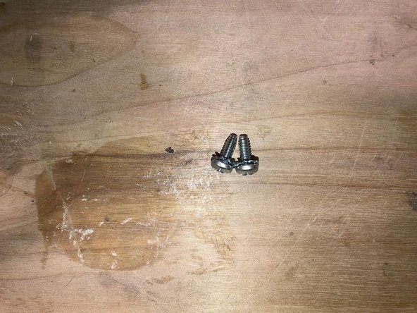

    • Now remove the two (2) Philips sheet metal screws
    • They are 3mm in diameter and 8mm long

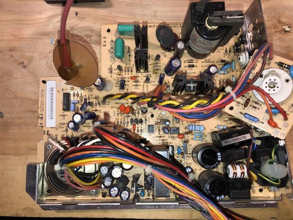

    • Now let's move the power board to the right of the chassis. Do those gently since there is still one cable attached
  16. Macintosh Classic II Power Board Removal: crwdns2935265:016crwdnd2935265:01crwdnd2935265:02crwdne2935265:0 Macintosh Classic II Power Board Removal: crwdns2935265:016crwdnd2935265:02crwdnd2935265:02crwdne2935265:0

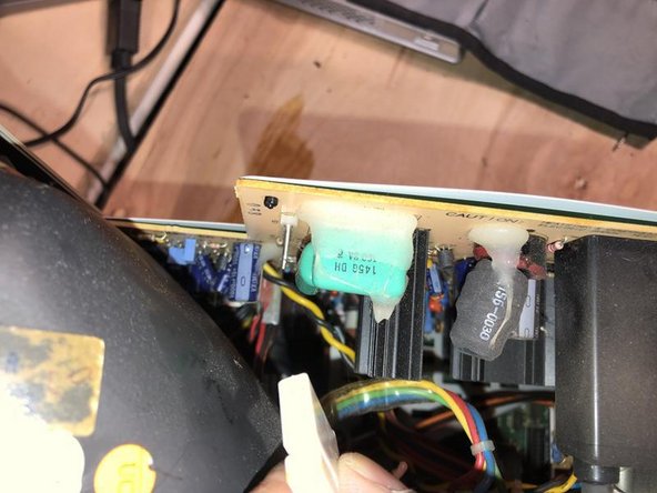

    • Remove the fan from the power board. The connector has a small tab that needs to be lifted to remove the connector
    • Now the board can be removed without difficutlies. this board looks like it has been recapped. Or Apple used some really high quality capacitors on the original....Nah. I don't think so. Anyhow, it's a clean board with no damage from leaking capacitors etc.
