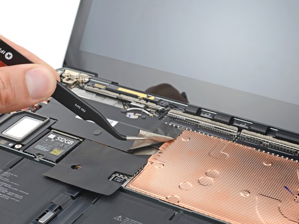

Soften protective tape or film
  • This step shows how to use your hair dryer to loosen protective tape and stickers.
  • Position the nozzle of your hair dryer 2–3 inches above the device and set the fan setting to "Low".
  • Apply heat in small circles over the tape or sticker for 30 seconds.
  • Peel the tape from the device.
