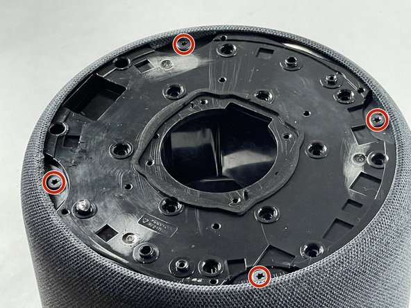

  • Remove the four 3.27 mm screws with T15 Torx driver.
  • After removing the screws, push/pull the inner shell out of the outer shell.
  • You might need someone's help to remove the inside shell, because it is very tight inside the outer shell.
