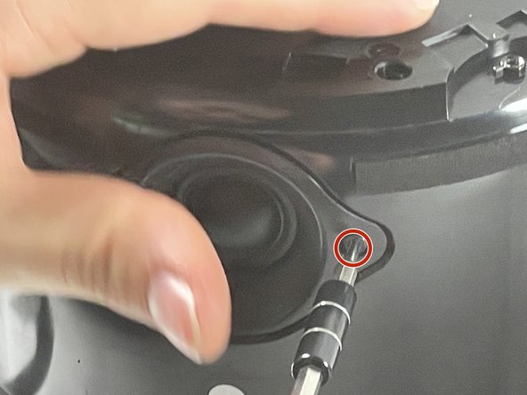

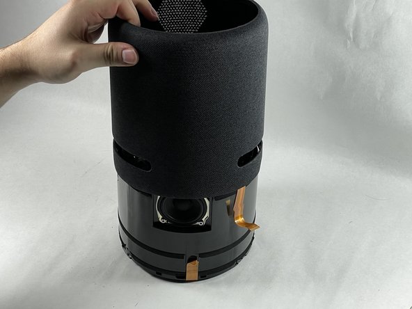

    1. Amazon Echo Studio Tweeter Replacement, Tweeter: crwdns2935265:015crwdnd2935265:01crwdnd2935265:03crwdne2935265:0 Amazon Echo Studio Tweeter Replacement, Tweeter: crwdns2935265:015crwdnd2935265:02crwdnd2935265:03crwdne2935265:0 Amazon Echo Studio Tweeter Replacement, Tweeter: crwdns2935265:015crwdnd2935265:03crwdnd2935265:03crwdne2935265:0
      • Remove the four 3.27 mm screws with T15 Torx driver.
      • After removing the screws, push/pull the inner shell out of the outer shell.
      • You might need someone's help to remove the inside shell, because it is very tight inside the outer shell.
    2. Amazon Echo Studio Tweeter Replacement: crwdns2935265:016crwdnd2935265:01crwdnd2935265:03crwdne2935265:0 Amazon Echo Studio Tweeter Replacement: crwdns2935265:016crwdnd2935265:02crwdnd2935265:03crwdne2935265:0 Amazon Echo Studio Tweeter Replacement: crwdns2935265:016crwdnd2935265:03crwdnd2935265:03crwdne2935265:0
      • Remove the wire from its slot inside the shell so the tweeter can be removed.
      • Unscrew the two 3.2 mm screws holding the tweeter in place with a T15 Torx screwdriver.
      • Pull the tweeter out.
