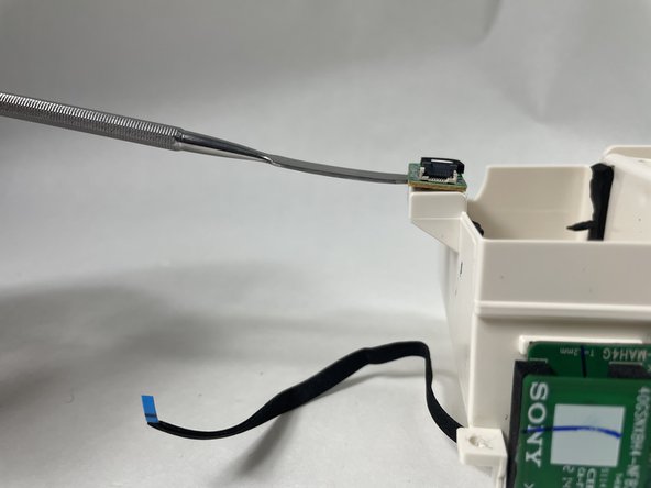

  • Insert the spudger below the LED control PCBs and pry to remove it from the plastic chassis.
  • The PCBs are held onto the chassis with a considerably strong double-sided tape. If the spudger is too thick and can not fit under the PCBs, use a thin plastic pick or plastic card.
