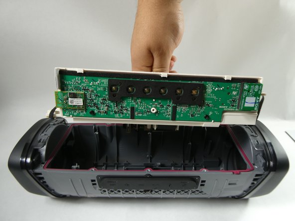

      • Slowly lift the speaker face off of the housing unit.
      • Unplug the six wires connecting the faceplate to the motherboard.

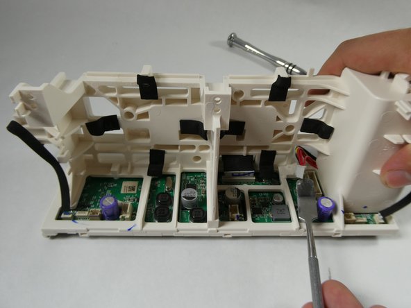

    2. Sony SRS-XB43 LED Module Replacement: crwdns2935265:06crwdnd2935265:01crwdnd2935265:03crwdne2935265:0 Sony SRS-XB43 LED Module Replacement: crwdns2935265:06crwdnd2935265:02crwdnd2935265:03crwdne2935265:0 Sony SRS-XB43 LED Module Replacement: crwdns2935265:06crwdnd2935265:03crwdnd2935265:03crwdne2935265:0
      • Orient the motherboard chassis so that the side with the six buttons is facedown on the table and the opposite side is visible to you.
      • Disconnect the seven-prong cable (the one with red, yellow, and black wires) plugged into the motherboard by prying on its edge/extruding lip with a spudger.

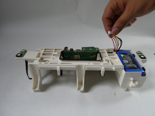

      • Lightly pull the seven-prong cable upwards until the battery is angled in such a way that you can get a proper grip on both sides with your fingers.
      • Using your fingers, pull upwards until the battery is removed from its enclosure.
      • Do not use a spudger or other flat tools to pry in between the seam of the battery and the battery compartment, as it is possible to damage the battery.

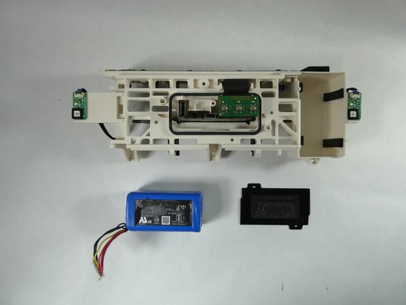

    1. Sony SRS-XB43 LED Module Replacement, LED Module: crwdns2935265:09crwdnd2935265:01crwdnd2935265:01crwdne2935265:0

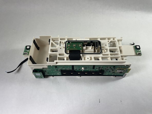

      • Orient the motherboard chassis so that the battery compartment is facing upwards.
      • Identify the two LED control PCBs located on the left and right edges of the plastic chassis.
    2. Sony SRS-XB43 LED Module Replacement: crwdns2935265:010crwdnd2935265:01crwdnd2935265:03crwdne2935265:0 Sony SRS-XB43 LED Module Replacement: crwdns2935265:010crwdnd2935265:02crwdnd2935265:03crwdne2935265:0 Sony SRS-XB43 LED Module Replacement: crwdns2935265:010crwdnd2935265:03crwdnd2935265:03crwdne2935265:0

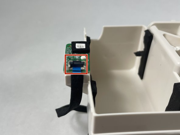

      • Identify the black latch on each of the plugs that are connected to the PBCs.
      • Swing the black latch open by gently prying the front/extruding lip of the plug with a spudger or other flat tool.
      • To give a sense of direction, the latch should swing away from you or towards the LED (metallic square).
      • Grab each ribbon cable and apply a horizontal pulling force (with respect to the LED control PCBs) to disconnect them from the connectors.
    3. Sony SRS-XB43 LED Module Replacement: crwdns2935265:011crwdnd2935265:01crwdnd2935265:03crwdne2935265:0 Sony SRS-XB43 LED Module Replacement: crwdns2935265:011crwdnd2935265:02crwdnd2935265:03crwdne2935265:0 Sony SRS-XB43 LED Module Replacement: crwdns2935265:011crwdnd2935265:03crwdnd2935265:03crwdne2935265:0

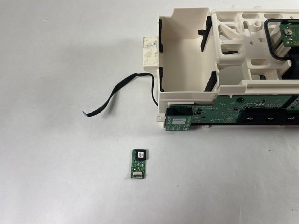

      Plastic Cards
      $2.99

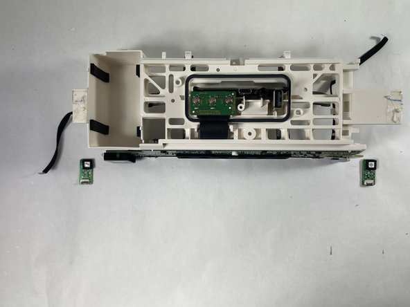

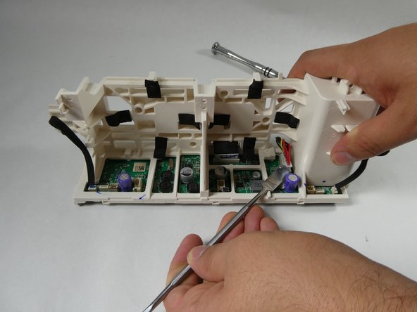

      • Insert the spudger below the LED control PCBs and pry to remove it from the plastic chassis.
      • The PCBs are held onto the chassis with a considerably strong double-sided tape. If the spudger is too thick and can not fit under the PCBs, use a thin plastic pick or plastic card.
