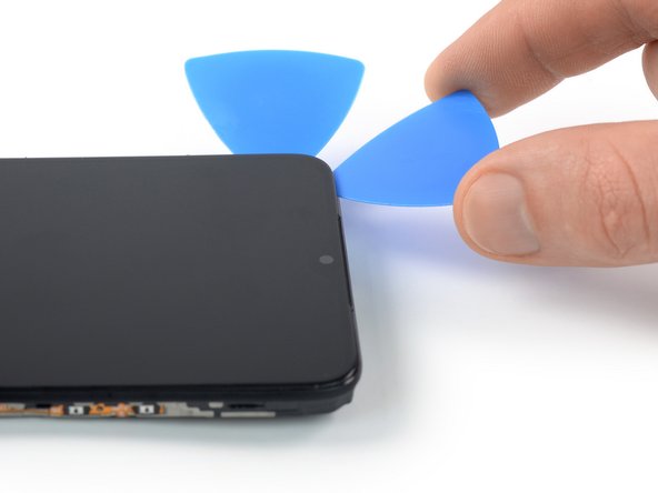

Slice the top edge adhesive
  • If the adhesive becomes hard to cut, it has most likely cooled down. Use your iOpener or heat gun for 1–2 minutes to reheat it.
  • When you slice near the front facing camera, insert only the tip of the opening pick (~2.5 mm) to avoid damaging or smearing the camera.
  • Insert a fourth opening pick at the top left corner of the screen.
  • Slide the opening pick along the top edge of the phone to slice the adhesive.
  • Leave the opening pick in the top right corner to prevent the adhesive from resealing.
