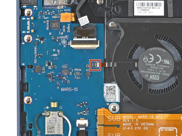

Samsung Galaxy Book Pro 360 15" Daughterboard Replacement, Disconnect the fan cable's ZIF connector: crwdns2935265:00crwdnd2935265:01crwdnd2935265:03crwdne2935265:0 Samsung Galaxy Book Pro 360 15" Daughterboard Replacement, Disconnect the fan cable's ZIF connector: crwdns2935265:00crwdnd2935265:02crwdnd2935265:03crwdne2935265:0 Samsung Galaxy Book Pro 360 15" Daughterboard Replacement, Disconnect the fan cable's ZIF connector: crwdns2935265:00crwdnd2935265:03crwdnd2935265:03crwdne2935265:0
  • Use the pointed end up a spudger to pry up the locking flap on the left fan cable's ZIF connector.
  • During reassembly, make sure that all seven cables are connected to the daughterboard.
Utiliza la punta de un spudger para levantar la pestaña de bloqueo del conector ZIF del cable del ventilador izquierdo.
Durante el montaje, asegúrate de que los siete cables están conectados a la placa base.
