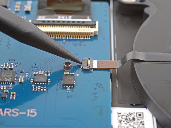

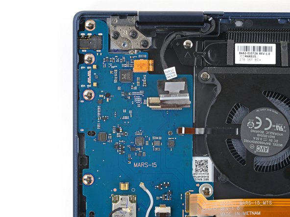

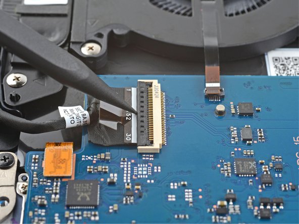

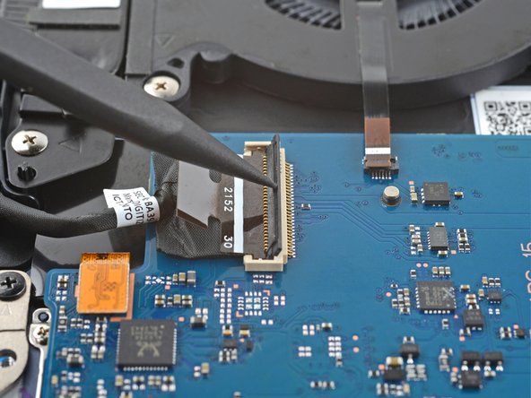

  9. Samsung Galaxy Book Pro 360 15" Daughterboard Replacement, Disconnect the fan cable's ZIF connector: crwdns2935265:09crwdnd2935265:01crwdnd2935265:03crwdne2935265:0 Samsung Galaxy Book Pro 360 15" Daughterboard Replacement, Disconnect the fan cable's ZIF connector: crwdns2935265:09crwdnd2935265:02crwdnd2935265:03crwdne2935265:0 Samsung Galaxy Book Pro 360 15" Daughterboard Replacement, Disconnect the fan cable's ZIF connector: crwdns2935265:09crwdnd2935265:03crwdnd2935265:03crwdne2935265:0
    • Use the pointed end up a spudger to pry up the locking flap on the left fan cable's ZIF connector.
    • During reassembly, make sure that all seven cables are connected to the daughterboard.

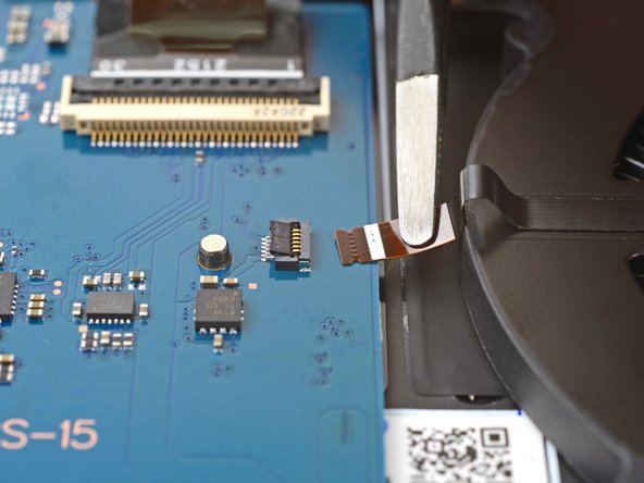

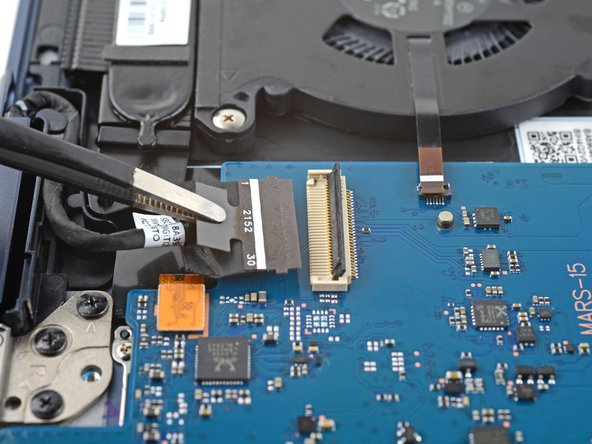

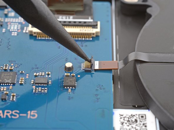

  10. Samsung Galaxy Book Pro 360 15" Daughterboard Replacement, Disconnect the fan cable: crwdns2935265:010crwdnd2935265:01crwdnd2935265:02crwdne2935265:0 Samsung Galaxy Book Pro 360 15" Daughterboard Replacement, Disconnect the fan cable: crwdns2935265:010crwdnd2935265:02crwdnd2935265:02crwdne2935265:0
    • Grip the left fan cable's pull tab with tweezers and gently pull the cable out of its socket.

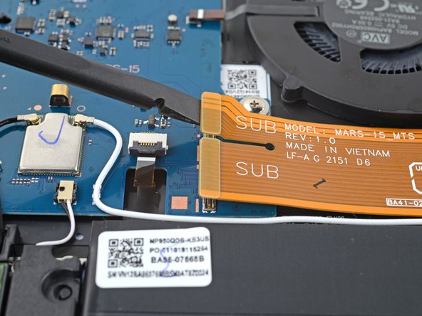

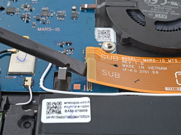

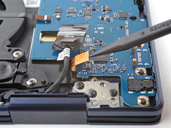

  11. Samsung Galaxy Book Pro 360 15" Daughterboard Replacement, Disconnect the interconnect cable: crwdns2935265:011crwdnd2935265:01crwdnd2935265:03crwdne2935265:0 Samsung Galaxy Book Pro 360 15" Daughterboard Replacement, Disconnect the interconnect cable: crwdns2935265:011crwdnd2935265:02crwdnd2935265:03crwdne2935265:0 Samsung Galaxy Book Pro 360 15" Daughterboard Replacement, Disconnect the interconnect cable: crwdns2935265:011crwdnd2935265:03crwdnd2935265:03crwdne2935265:0
    • Use the flat end of spudger to pry up and disconnect both of the interconnect cable's press connectors from the daughterboard.
    • To re-attach press connectors like these, carefully align and press down on one side until it clicks into place, then repeat on the other side. Don't press down on the middle. If the connector is misaligned, the pins can bend and cause permanent damage.

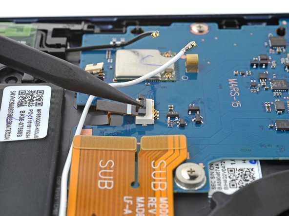

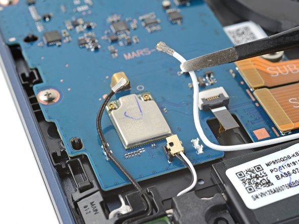

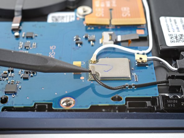

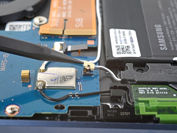

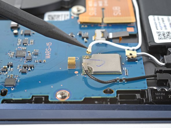

  13. Samsung Galaxy Book Pro 360 15" Daughterboard Replacement: crwdns2935265:013crwdnd2935265:01crwdnd2935265:03crwdne2935265:0 Samsung Galaxy Book Pro 360 15" Daughterboard Replacement: crwdns2935265:013crwdnd2935265:02crwdnd2935265:03crwdne2935265:0 Samsung Galaxy Book Pro 360 15" Daughterboard Replacement: crwdns2935265:013crwdnd2935265:03crwdnd2935265:03crwdne2935265:0
    • Insert the pointed end of a spudger under the black antenna cable and slide it as close to the connector as possible.
    • Gently lift straight up to disconnect the antenna.
    • The connector is very delicate and can easily break if a quick or strong force is applied.
    • Repeat the disconnection procedure on the white antenna cable.
    • To reattach coaxial connectors like these, align the connector over its socket and press down with the flat end of a spudger. The connector should snap into place. This can be tricky and may take a few tries.

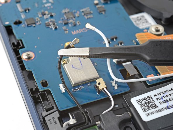

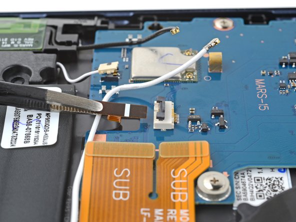

  14. Samsung Galaxy Book Pro 360 15" Daughterboard Replacement: crwdns2935265:014crwdnd2935265:01crwdnd2935265:03crwdne2935265:0 Samsung Galaxy Book Pro 360 15" Daughterboard Replacement: crwdns2935265:014crwdnd2935265:02crwdnd2935265:03crwdne2935265:0 Samsung Galaxy Book Pro 360 15" Daughterboard Replacement: crwdns2935265:014crwdnd2935265:03crwdnd2935265:03crwdne2935265:0
    • Use tweezers or your fingers to lift the black and white antenna cables out of their clips on the daughterboard.
  15. Samsung Galaxy Book Pro 360 15" Daughterboard Replacement: crwdns2935265:015crwdnd2935265:01crwdnd2935265:02crwdne2935265:0 Samsung Galaxy Book Pro 360 15" Daughterboard Replacement: crwdns2935265:015crwdnd2935265:02crwdnd2935265:02crwdne2935265:0
    • Use the pointed end of a spudger to pry up the locking flap on the backlight cable's connector.
  16. Samsung Galaxy Book Pro 360 15" Daughterboard Replacement: crwdns2935265:016crwdnd2935265:01crwdnd2935265:02crwdne2935265:0 Samsung Galaxy Book Pro 360 15" Daughterboard Replacement: crwdns2935265:016crwdnd2935265:02crwdnd2935265:02crwdne2935265:0
    • Grip the backlight cable's pull tab with tweezers and gently pull the cable out of its socket.
  17. Samsung Galaxy Book Pro 360 15" Daughterboard Replacement: crwdns2935265:017crwdnd2935265:01crwdnd2935265:03crwdne2935265:0 Samsung Galaxy Book Pro 360 15" Daughterboard Replacement: crwdns2935265:017crwdnd2935265:02crwdnd2935265:03crwdne2935265:0 Samsung Galaxy Book Pro 360 15" Daughterboard Replacement: crwdns2935265:017crwdnd2935265:03crwdnd2935265:03crwdne2935265:0
    • Use a spudger to pry up the locking flap on the left display cable's ZIF connector.
  18. Samsung Galaxy Book Pro 360 15" Daughterboard Replacement: crwdns2935265:018crwdnd2935265:01crwdnd2935265:02crwdne2935265:0 Samsung Galaxy Book Pro 360 15" Daughterboard Replacement: crwdns2935265:018crwdnd2935265:02crwdnd2935265:02crwdne2935265:0
    • Grip the left display cable's pull tab with tweezers or your fingers and gently pull the cable out of its socket.

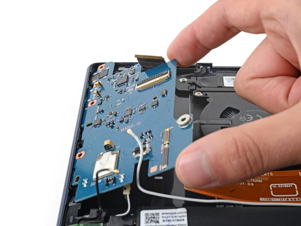

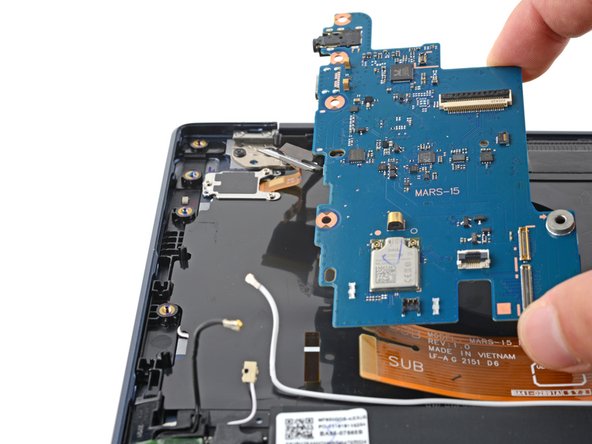

  21. Samsung Galaxy Book Pro 360 15" Daughterboard Replacement, Remove the daughterboard: crwdns2935265:021crwdnd2935265:01crwdnd2935265:03crwdne2935265:0 Samsung Galaxy Book Pro 360 15" Daughterboard Replacement, Remove the daughterboard: crwdns2935265:021crwdnd2935265:02crwdnd2935265:03crwdne2935265:0 Samsung Galaxy Book Pro 360 15" Daughterboard Replacement, Remove the daughterboard: crwdns2935265:021crwdnd2935265:03crwdnd2935265:03crwdne2935265:0
    • Lift the right side of the daughterboard up and pull towards the center of the laptop to remove it.
    • During reassembly:
    • Move all cables that connect to the daughterboard (display, fingerprint, interconnect, speaker, backlight, and antennas) out of the way so they don't get stuck under the daughterboard when it's reinserted.
    • Reinsert the daughterboard at a downward angle to position the headphone jack, USB-C port, and memory slot back into their recesses.
    • Before securing the daughterboard, make sure the alignment pins on the frame are in their cutouts on the daughterboard.
