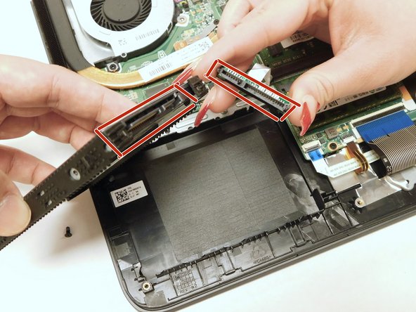

  • Observe the port connection and match it with the drives slot.
  • Connect and press firmly.
  • Install black rubber pieces on to the drive.
  • Place the drive into its slot.
  • Install the drive by placing the end with connectors in first, then gently pushing the other end down into its slot.
