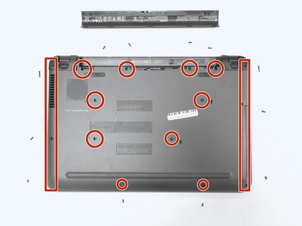

  4. HP Star Wars Special Edition 15-an051dx Hard Drive Replacement, HDD/SSD: crwdns2935265:04crwdnd2935265:01crwdnd2935265:03crwdne2935265:0 HP Star Wars Special Edition 15-an051dx Hard Drive Replacement, HDD/SSD: crwdns2935265:04crwdnd2935265:02crwdnd2935265:03crwdne2935265:0 HP Star Wars Special Edition 15-an051dx Hard Drive Replacement, HDD/SSD: crwdns2935265:04crwdnd2935265:03crwdnd2935265:03crwdne2935265:0
    • Ensure that the laptop is completely powered off and unplugged from any power source from the beginning.
    • Slide the battery release tabs to the left, and then remove the battery.
    • Using a Philips #1 screwdriver, remove the following screws from the base panel:
    • Two 12.5 mm screws
    • Four 5.5 mm screws and six 7.25 mm screws
    • Organize and make sure to label the screws by size and location for easy reassembly.
    • Gently remove the two corner panels located at each end of the batteru slot to reveal an additional screw under each panel.
    • Locate and then remove the six remaining 7.25 mm screws hidden in the battery compartment and also beneath the corner panel covers.

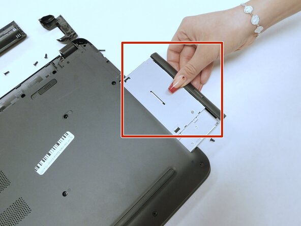

  5. HP Star Wars Special Edition 15-an051dx Hard Drive Replacement: crwdns2935265:05crwdnd2935265:01crwdnd2935265:03crwdne2935265:0 HP Star Wars Special Edition 15-an051dx Hard Drive Replacement: crwdns2935265:05crwdnd2935265:02crwdnd2935265:03crwdne2935265:0 HP Star Wars Special Edition 15-an051dx Hard Drive Replacement: crwdns2935265:05crwdnd2935265:03crwdnd2935265:03crwdne2935265:0
    • Remove the optical drive by pulling on the plastic cover panel.

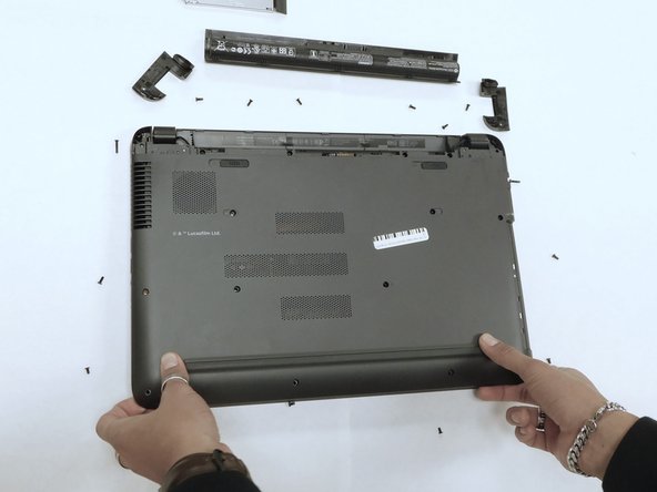

    • Using a prying tool, gently pry the back panel off.
    • Start with the device's corners and carefully slide the tool towards the middle, lifting the panel as you go.

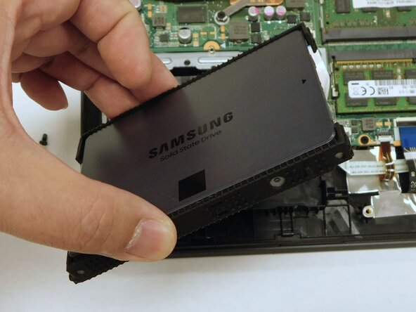

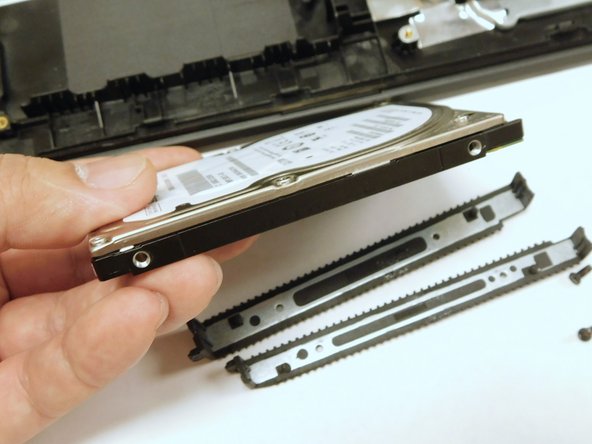

    • Lift The Drive
    • Gently lift the left side of the hard drive to detach it from the mounting bay.
    • The drive will have two rubber pieces on its side that helps it stay mounted on the device.
    • Detach Rubber Mounts
    • Gently pull the rubber mounts away from the drive to release it.

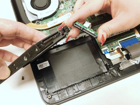

    • Disconnect the Cable:
    • Locate the plastic tab on the connecting table.
    • Carefully pry the tab upward to disconnect the cable from the hard drive. Avoid pulloing the cable directly to prevent damage.

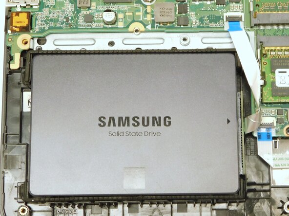

  7. HP Star Wars Special Edition 15-an051dx Hard Drive Replacement: crwdns2935265:07crwdnd2935265:01crwdnd2935265:03crwdne2935265:0 HP Star Wars Special Edition 15-an051dx Hard Drive Replacement: crwdns2935265:07crwdnd2935265:02crwdnd2935265:03crwdne2935265:0 HP Star Wars Special Edition 15-an051dx Hard Drive Replacement: crwdns2935265:07crwdnd2935265:03crwdnd2935265:03crwdne2935265:0
    • Observe the port connection and match it with the drives slot.
    • Connect and press firmly.
    • Install black rubber pieces on to the drive.
    • Place the drive into its slot.
    • Install the drive by placing the end with connectors in first, then gently pushing the other end down into its slot.
