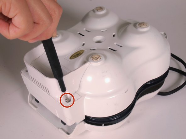

  • Flip the ShellBaker over so that you are looking at the bottom of it.
  • Remove the two 12.7mm screws on the end opposite the handle that attach the bottom stand to the base of the machine with a Phillips #2 screwdriver.
